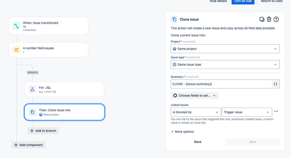

Your rule might look something like this:
