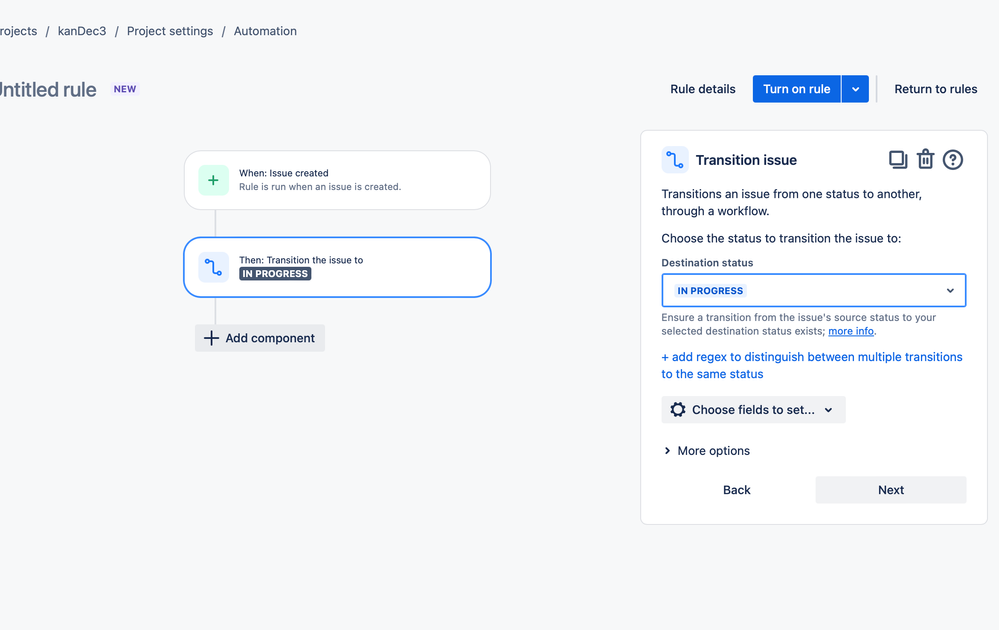

I am trying to create issues not in the Parking Lot. Workinng for a start up, I often recieve ideas which we need to begin next sprint, hence I would like to create the ideas in the "next sprint" status.

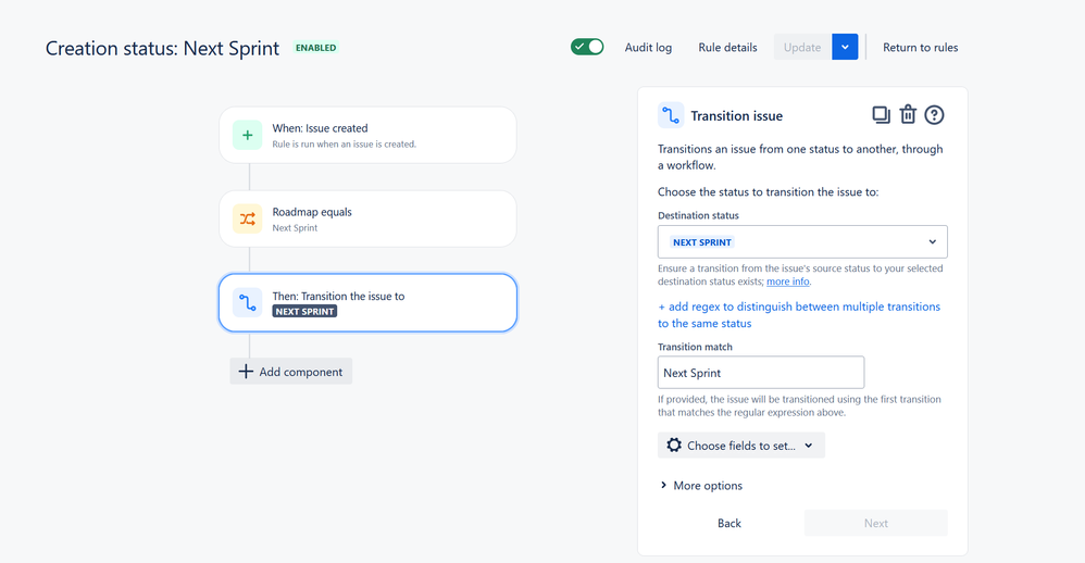

I have a custom field, called "Roadmap" which one-for-one aligns with my status. I have this so that I can color-code my cards. It seems like I cannot color code statuses.
I then wrote automation, when an idea is created, if roadmap equals "Next Sprint", then transition the status to Next Sprint.

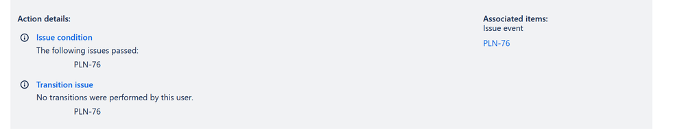

This automation never works, it always turns up with this transition issue:
As depicted above, I've tried turning on the regex button but that doesn't seem to solve the issue.

Hello, Good day. You are manually able to transition the issue ?
Also make sure that there is no condition in the workflow transition.
Mohanraj Thangamuthu
December 26, 2024
Also try only the transition to next status without any further actions.

From the screenshot that you have shared above, I see that you have selected "transition match". Could you try disabling this?
Donni Shimanovich
December 30, 2024

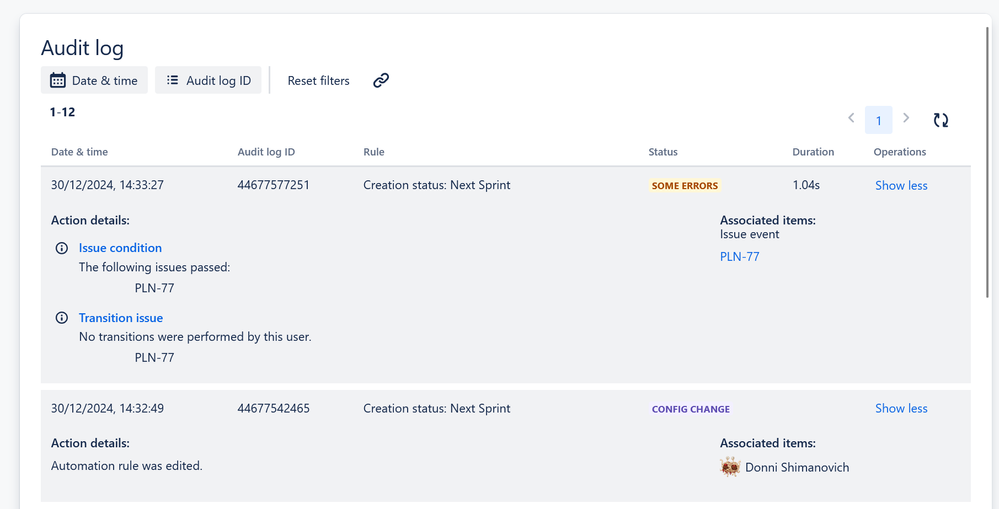

Hi. I just tried disabling it and I am still experiencing the same issue.
December 30, 2024
Thanks. There are chances that the automation user does not have transition permission. Could you try changing the automation rule actor to your name/account and check ?
Donni Shimanovich
December 30, 2024
That worked and I feel silly. I have many other automation where I remembered to update the actor, I just missed this set of rules. Thank you.
