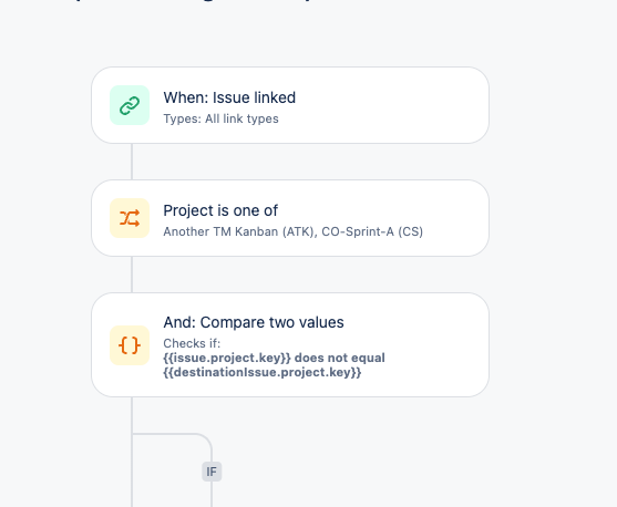

Hello @Jack Crowe
I apologize that I haven't gotten back to you sooner.

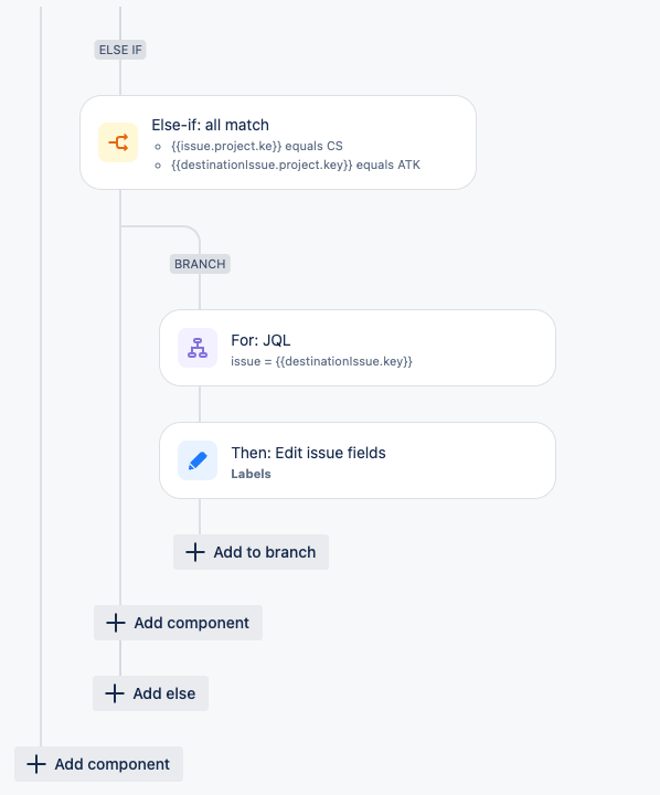

Here is a rule that works. In my example "ATK" is the project where I want the label added to the issue, and "CS" is the other project in the link pairing.
The "IF" is an "IF-ELSE Condition"
Screenshot 2024-08-04 at 5.49.36 PM.pngScreenshot 2024-08-04 at 5.49.52 PM.png

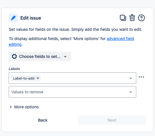

The Edit Issue Fields action looks like this:

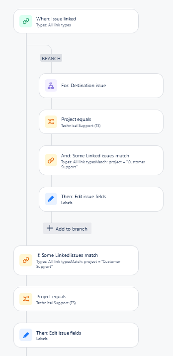

Jack Crowe
August 26, 2024
I got some reports from colleagues and ended up with this logic, which I hear is working.. correctly.
Thanks @Trudy Claspill for the input, your answer seems better and I will use it if I come back to edit it!
Here's my version for posterity:

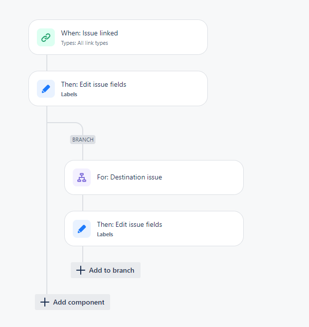

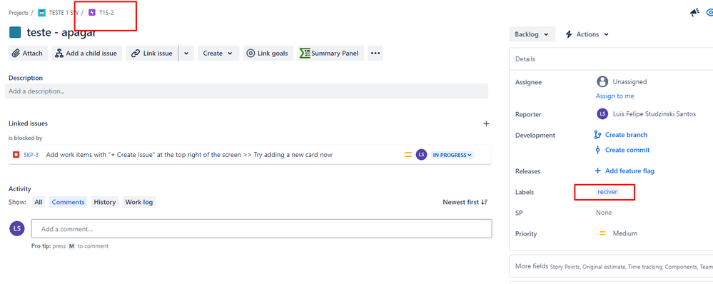

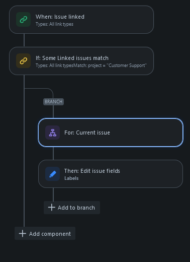

@Jack CroweHello,
See this possibility. The first edit is for the issue that is in the link and the second edit is for the issue that received the link.
Also, the automation must be of Global scope

@Luis Felipe Studzinski Santos
I don't think your solution matches the author's requirement:
when an issue from a certain project is linked to an issue in another certain project

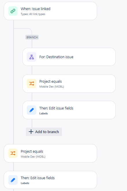

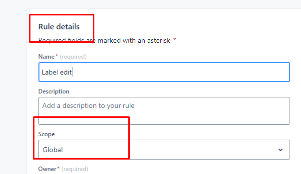

Hi @Jack Crowe, if I understand you correctly you can apply something shown in the example below. Notice two things:
  1. You will need to apply the rule scope accordingly to your requirements.
  2. You must handle linking automation from both sides (hense bullet #1 above):
    1. The linking is done while "standing" in the project where you need to set the label.
    2. The linking is done while "standing" any other projects.
In my example I will label the issues on project MOBL, and only if the other project is FAC. But you can add as many projects as needed, or make i global (all projects).
Regarding bullet #1
The image below shows the rule details dialog from the MOBL automation view.
The image below shows the same rule details but from the Global administration view.
In the Scope dropdown you select according to your requirements, and if not using Global scope add the wanted projects (ref yellow marking).
The rule
This rule triggers when linking is done in any projects within the rule scope.
The main thread will handle linking done from "the project", ref bullet #2.1
The branch will handle any linking done when from "other projects", ref bullet #2.2.
The filters applied make sure labels are only set on the MOBL project. E.g. if global scope you will add labels "everywhere" when a linking occurs if fileter is not applied as shown above.
TimK
