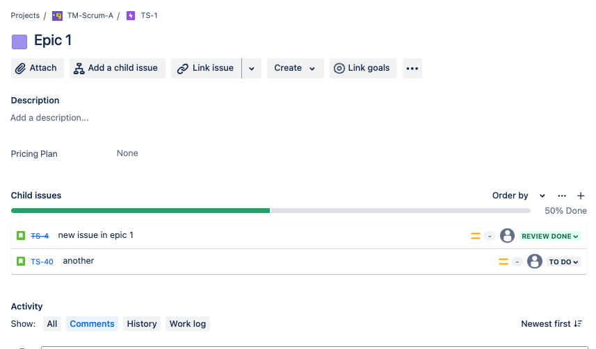

You have Epics that have issues appearing in the Child Issues section:
You want to add an issue link between these Epics and their Child issues so that the child issues also appear in the Issue Links section?

Hi Trudy, Yes, that is exactly what I am looking to do.
