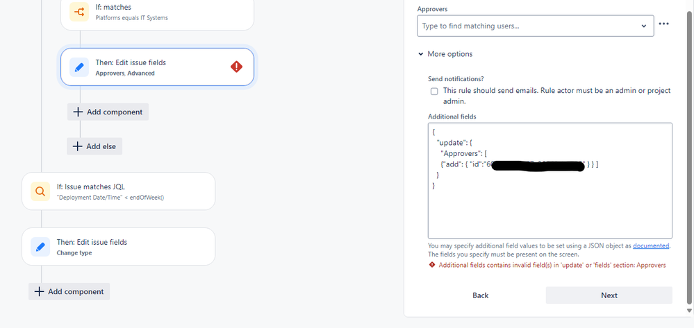

The issue I am coming across in my automation is that when I add an If statement for the department, my Then action overwrites the three main approvers I had originally set. The goal will be to add departmental specific approvers to the original three master approvers previously set.
I believe the solution is to use JSON to accomplish this, but I am hitting an error I don't fully understand.
{ "update": { "Approvers": [ {"add": { "id":"myuser'sID" } } ] } }
Returns with the error "Additional fields contains invalid field(s) in "update" or "fields" section: Approvers
I am fairly certain the Approvers field is correct, so I am looking to get a second set of eyes to see what I may need to adjust.

That error can be a bit confusing.  What is means is the Edit Issue action cannot select a specific field from both the dropdown list and use it in advanced edit with JSON.  One of them needs to be removed.

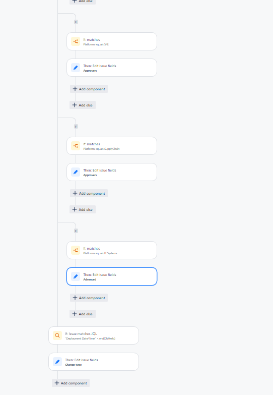

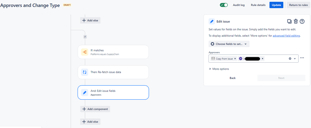

Thank you for your suggestions! It currently isn't configured in the most efficient way I'd imagine. Because my department list is lengthy, I have an If statement for each of them which makes it to where I cannot grab the whole automation in a single screenshot.

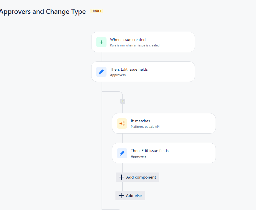

I start by setting the three main approvers first on the creation of this change type.
From here I have a long list of "if:matches" for each of the department names. I was hoping to use the "Then: Edit issue fields" in order to add approvers to the original three depending on what department is selected.

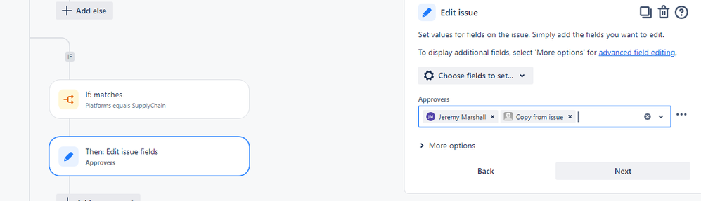

This is the portion where I am trying the JSON to add another user to the Approvers field without overwriting the initial three that were created in the first screenshot.
I've run the automation with the JSON I listed originally, and it shows successful on the audit.  I see that the three original approvers were overwritten by the department's approver.
Here I see the departmental Approver overwrote the three main Approvers.

I followed your suggestion and updated my automation the include the action: re-fresh issue after it was created, after the 3 default approvers were added, and then after the If / Else logic. The 3 default approvers were still being overwritten by the departmental user in the If / Else logic. I then tried to use the "Copy from Issue" along with the departmental approver but that did not work as well.

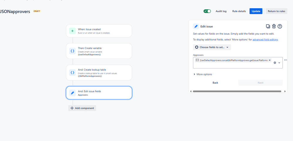

I ran through a test of your JSON suggestion by adding the default approvers and creating a lookup table for one of the Departments with the userID.
In my Audit log I receive an error "Error while parsing additional fields. Not valid JSON."
I am using the following to try and edit the approvers field using split you gave an example of.
@Bill Sheboy  Thank you so much for taking the time to review this with me.

I just tried what I suggested and it worked for me to paste that expression into the Approvers field.
Would you please post an image of the audit log details to show what did not work as expected?
Is your Platform, custom field single or multiple selection?

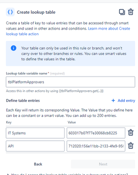

Thanks again @Bill Sheboy for your suggestions. I configured a lookup table with a couple of the Platform custom field so I could test. This field is Single Selection.
I then pasted the smart value for the concat of the three main approvers with the selected value from the table.

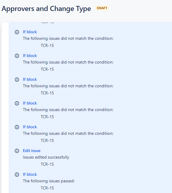

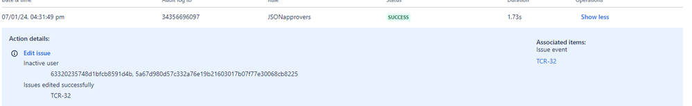

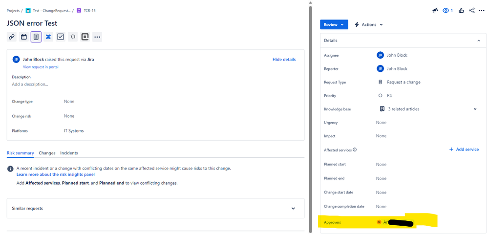

On the test tickets I create, I see the three main approvers but have not seen the Platform approvers getting added to the Approvers. My audit is showing success however.
Bill Sheboy
July 1, 2024
That log shows one of the three users is inactive, and so perhaps that prevents adding the approvers.  Try removing that one.
John Block
July 1, 2024
I confirmed that all three main approvers and the departmental approver are active. I then ran a test by removing one of the main approvers and running again. What looks like is happening is the departmental approver gets added without a comma, so the audit looks like it is combining two User IDs. This would explain the inactive user message on the audit.
I was unable to see this previously due to there not being enough space to display the full log.
I see now in my original Smart value I missed putting a comma behind the last UserID. By adding that comma it looks to be working. I am going to verify with a few more table values and then mark your answer. You Rock @Bill Sheboy !
