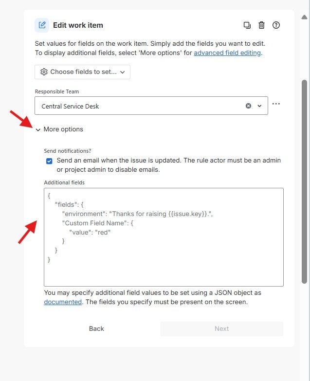

Hi @Christos Markoulatos , I couldn't find the advanced JSON you mentioned... where do you find it?
Hey @elyn 👋
The Advanced JSON option is under More options → Additional fields in the Edit work item action. That’s where you paste the JSON payload to set Jira Product Discovery date fields.

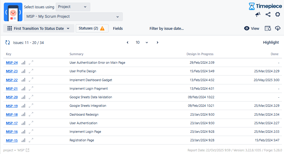

Hey @elyn
Using Jira Automation with custom date fields can be helpful but tricky, especially with potential field context or permission issues causing those errors.
An alternative approach is to use a reporting app to get this data directly from the issue history, which avoids the complexity of automation rules.
If you are open to using a marketplace app, Timepiece - Time in Status for Jira has a report designed for exactly this scenario.
Its First Transition To Status Date report is built to show you the exact date and time an issue first entered a specific status. To get what you need, you would simply:
The report will then give you a clean list of your issues, with one column showing your "Start Date" (the date it entered "Design In Progress") and another column showing your "End Date" (the date it entered "Done").
The best part is that this works for all your past issues immediately, since it reads from the existing issue history.
Besides, Timepiece has 15+ report types, automation and alert system, and so much more.
You can check it out on the Atlassian Marketplace. Hope this helps you get the data you need!

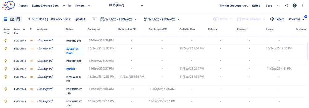

Hi @elyn ,
If you don't mind using third-party apps, I can recommend using the Time in Status app developed by my team.
In this article, we described in detail how you can track the life cycle of an idea in JPD.
In particular, I recommend using the Status Entrance Date report to see when your idea entered different statuses.
I hope you find it useful!

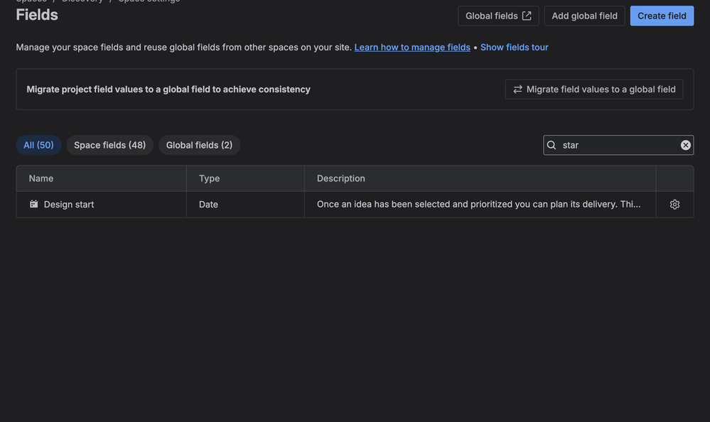

Hi @elyn -- Welcome to the Atlassian Community!
First thing: Jira has a built-in field named "Start Date" so using the same name could lead to confusion / errors. From what you describe, I recommend renaming your fields to "Design Start Date" and "Design End Date".
Next, Jira Product Discovery (JPD) has its own date format, using a JSON expression represented as text to hold a single date, a date range, or a quarter. It looks like this:
"customfield_12345": "{\"start\":\"2025-10-15\",\"end\":\"2025-10-15\"}"
Please note both parts (start and end) are required even when only specifying a single date value. For your case, you likely want to set them to the same value: {{now.jiraDate}}

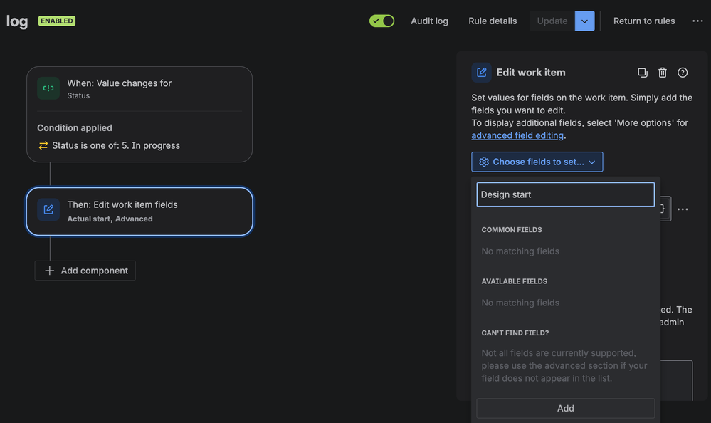

Hi Bill, thanks for the reply, i tried changing the labels of the property as what you mentioned "Design start" "Design end", but somehow when i reach to the automation dropdown selection, it does not appear... am i missing something?
Thanks for that additional information, @elyn
Some custom fields do not appear in the dropdown lists for rule actions. Instead the custom field ID may be used with an advanced edit with JSON.
To identify that ID and if the field is supported by automation rules, please use thus how-to article:
https://support.atlassian.com/cloud-automation/docs/find-the-smart-value-for-a-field/
