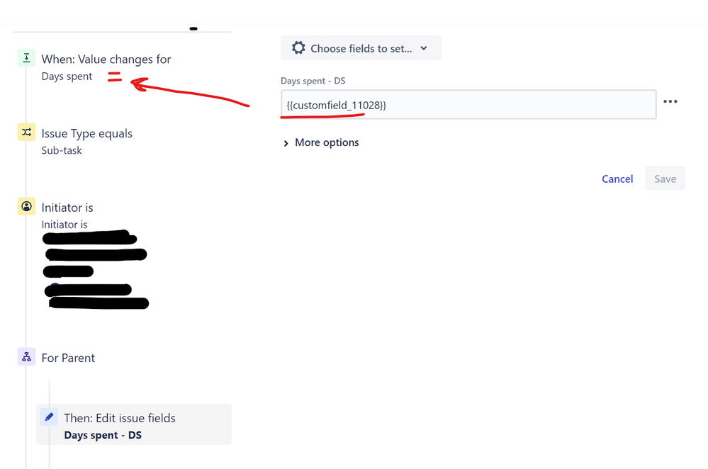

Hi everyone,
I've created an automation that takes a number value (from a custom field) in a sub-task and adds it to a field (also a numeric field) in the parent Story.
The automation shows 'Success' but the actual value in the story is None (instead of the numeric value from the trigger subtask).
I'd love to get some help here..thanks!

Hi @Alon Shoham
You are trying to copy the value from the trigger issue (subtask) to the parent issue, correct?
If so, you need to reference the trigger issue with:
{{triggerIssue.customfield_11028}}
If instead you are trying to sum the value for all children subtasks, rather than copy one, that would require a different value, using the parent to gather the subtask values:
{{issue.subtasks.customfield_11028.sum}}

Alon Shoham
October 26, 2022
Wow Bill it's working !! Thank you so much!
Such a tiny detail that took me hours to work on!
Thank again!
Bill Sheboy
October 26, 2022
I am glad to learn that it is working now!
This is a common symptom for rule writing, and something to remember is the meaning of {{issue}} depends on where you are in a rule...For example:
  • trigger: some trigger  At this point, both {{issue}} and {{triggerIssue}} refer to the issue(s) which started the rule.
  • action: some action  No change in meaning yet.
  • branch: some branch to issues  No change in meaning yet.
    • action: another action  Inside of a branch...{{issue}} refers to the issue(s) branched-to and {{triggerIssue}} refers to the issue(s) which started the rule.
  • action: some other action  Again outside of the branch, both {{issue}} and {{triggerIssue}} refer to the issue(s) which started the rule.
