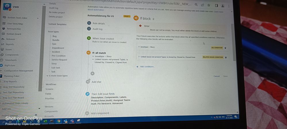

Aswathi D
November 1, 2022
Hi
 @Gaurav ,
Thanks for your continuous support .
When I clicked on publish changes , I am getting the below error ..Am I doing anything wrong ?

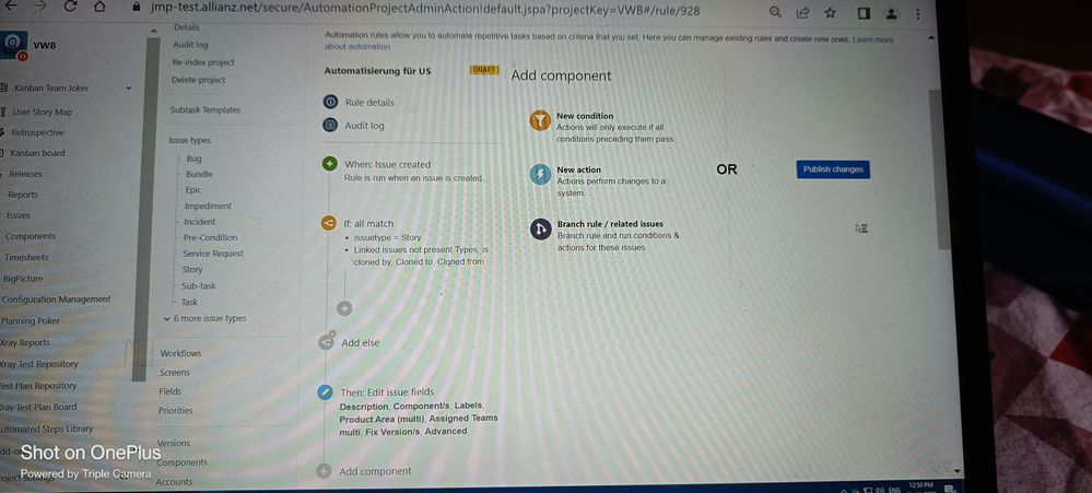

Aswathi D
November 1, 2022
Gaurav
November 1, 2022
Hello @Aswathi D
The action step (pencil icon in blue) of the Automation rule is misplaced. This needs to be placed under the If block where you have the 'Plus icon in Grey'.

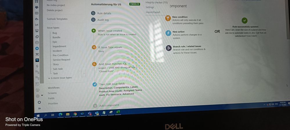

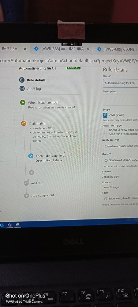

Aswathi D
November 1, 2022
Hi @Gaurav
Unfortunately ,it is not working ..still the description is not getting cloned .IMG20221101141408.jpg
Gaurav
November 1, 2022
Hello @Aswathi D
This is strange!!
Could you please share the Description which is showing up on the Clones Issue? Is the description of the clone issue matching the description defined in the Automation Rule?
Also, please share the Issue Links on the clone issue and the audit logs for the Automation rule.
These will help in identifying the problem here.
--GG

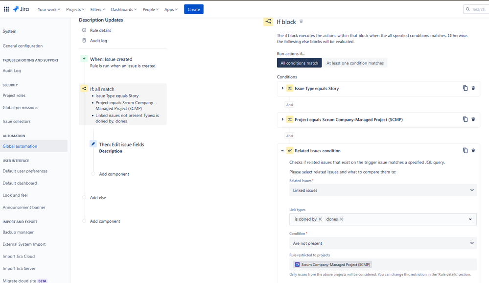

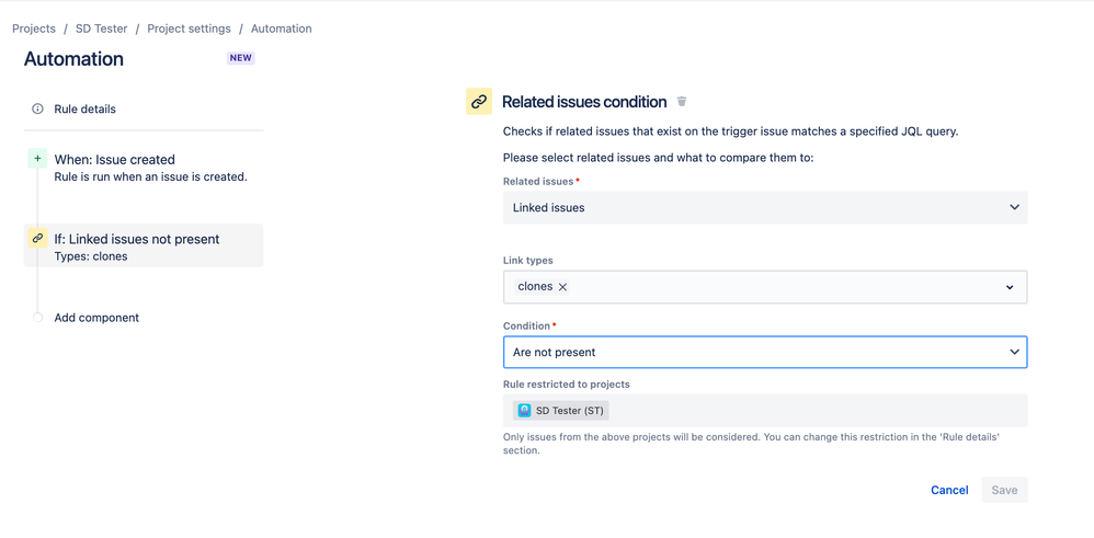

Ismael Jimoh
October 31, 2022
@Aswathi D cloning an issue is the same as creating an issue in JIRA with just specific fields being auto-populated. It is a new independent issue as far as the application is concerned.
A possible workaround for you would be to update your automation and check for the issue link clones. If this is not true then run your automation.
In your condition you can use Related issues -> clones -> Are not present see image
This should ensure that your cloned issue doesn't trigger the rule.
