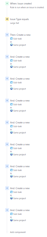

The idea is to automate a process: regularly new expansions (of our business topic) are released and our marketing department always has to do the same tasks as it happens. There can be 4 different scenarios, based on how big the expansion is, so they already created 4 different issue types.
Different "sub-departments" of the marketing department then need to fulfill their tasks and they all have their own boards in the same Jira project.
I hope it is readable: 2022-08-11 12_44_37-Automation - Jira.png
So what I did so far is that for expansion case 1 (out of 4 different cases) 9 subtasks are created. The issue is, that upon creation there are only 2 subtasks in the ticket.

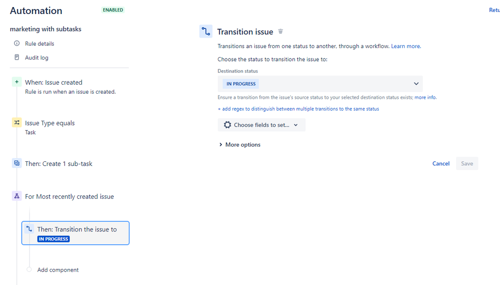

I tested the behaviour within my site and it worked fine. I also immediatly transitioned the status of each subtask with a "most recently created issue" branch after each subtask creation (see screenshot):

So the rule goes:
- when issue is created (I changed nothing there),

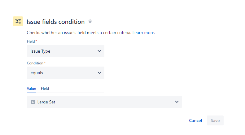

- issue type equals - here I set it as follows:

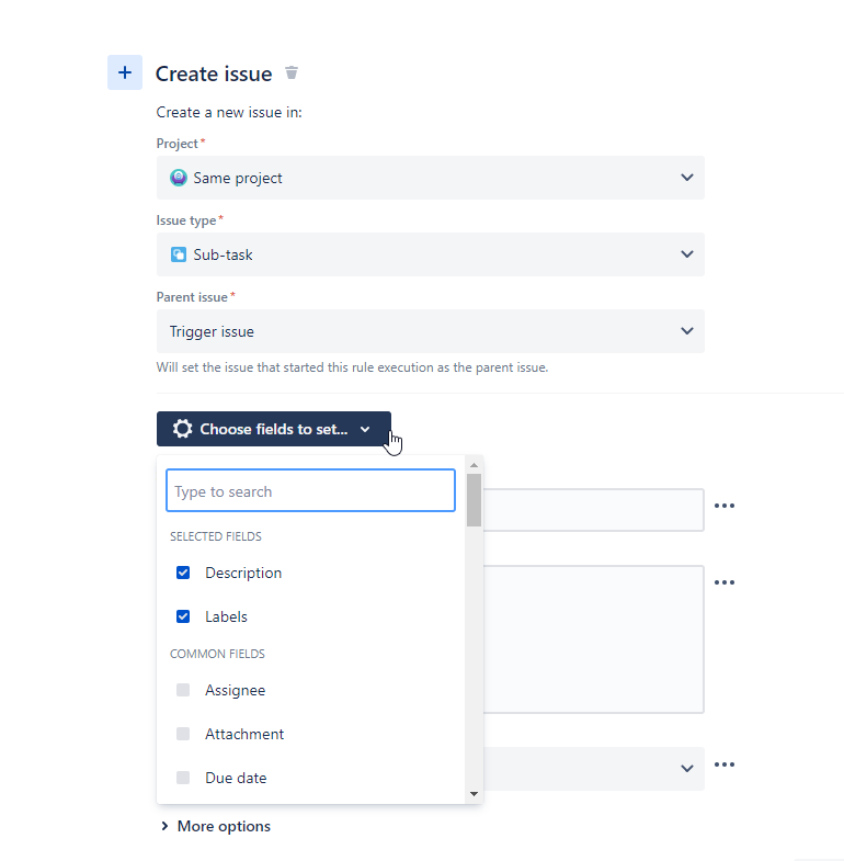

- then create a new sub-task, with the following settings:

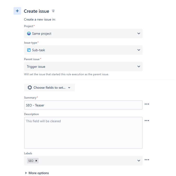

I also selected label, because 2 of these 9 sub tasks should go on the SEO board, 1 to social media etc:
I created the same trigger ("Then create a new subtask"), but with different lables, 9 times.
Thank you for the tipp on creating the status transition within the rule! These are on stack so if I create the one for SEO first and this one has the "most recently created issue should be moved to SEO TO DO", and I then create one for social media, I could use the same branch logic, to move that subtask then to SOCIAL MEDIA TO DO?

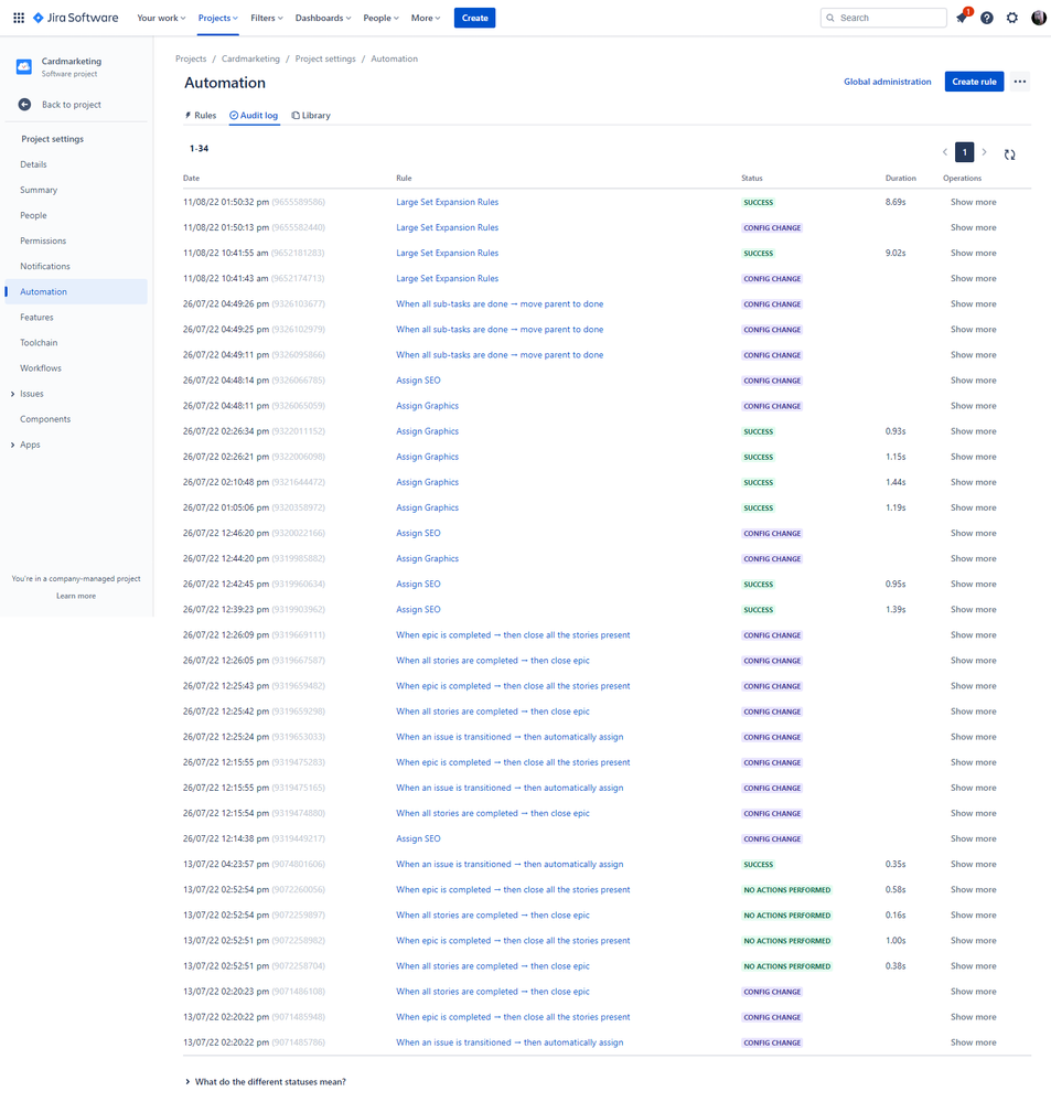

And the audit log:

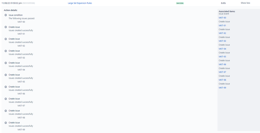

Please open the details of the audit log by clicking "show more"

Boards are only views based on a filter. So (assuming SEO To Do and SOCIAL MEDIA To Do are several status) you would not need the labels. You could just move the special subtask immediatly to the required status and (assuming boards are based on status) shown in the right board.

"Success":
Actually this audit log was very useful, because seing the issue links I clicked one and they vere actually created. Opening the ticket again and all the sub-tasks are there! So it must have been just a sync issue...
Thank you so much for your help and so sorry for wasting your time. Had I been more patient and checked periodically, I would have found out eventually...
