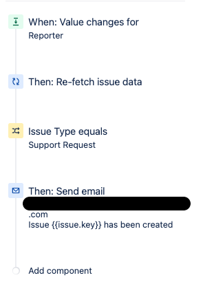

I am using JSM as a way for engineers to log support requests without having to work out the correct team.   We have automation working where the JSM ticket is created and then it will create another ticket in the correct backlog and close the original JSM ticket.
The last step which is not working  - We would like to email the reporter to let them know that a ticket has been raised in the correct backlog.
My issue seems to be that the rule to email the reporter is not being triggered.Screenshot 2022-06-15 at 12.02.43.png
I've tried all kinds of different triggers... so maybe there's a difference if the ticket is created automatically??
I can run it manually or use the create ticket option within the project and the rule runs.... just not when a ticket is automatically created

Easy fix here: by default automation rules can not be triggered by other automation rules.
Open your rule and go to the rule details. You will see a checkbox Check to allow other rule actions to trigger this rule. Only enable this if you need this rule to execute in response to another rule. You need to enable this option.

Christopher Atkinson
June 15, 2022
Thank you so much!!! Worked straight away!

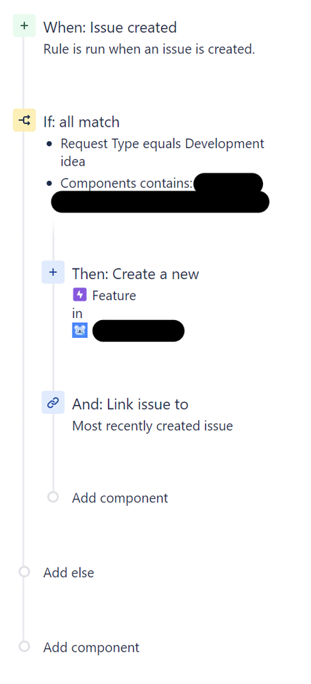

Could you share how you got the JSM ticket creation to create another jira ticket? I have created an automation which works, when I as admin create the ticket, but then when the customer creates a ticket, the automation does not create the jira ticket. I can't figure out where the issue is, so all ideas are highly appreciated.
Thanks inadvance for all help.
