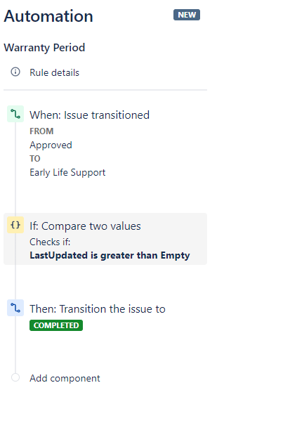

Can you please help with this requirement. We have a issue item workflows, of which I want to automate transitioning for this scenario.
After an issue is moved to workflow X, after 4 weeks from this date, automatically transition the workflow to Y (if there are no open bugs, issues, tasks,...) is that possible? I started the below which I hope is a good starting point.
Thanks.

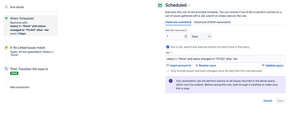

As mentioned above by Alex one method would be to set a custom date field, then have a scheduled rule that checks the date saved. JQL by default should support time in status checks though, so you can use this provided you don't care which status is transitioned  from otherwise you should do the above, anyway if not you can do something like: status != "Done" and status changed to "TO DO" after -4w.

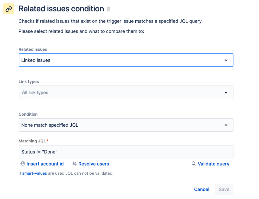

Regarding your mention if no linked issues being opened, you can also use a "Related issue condition" and provide JQL to check if one of them isn't Done or Open depending on your setup.
Here's my example of course you'll need to change statuses based on your workflows, might be worth testing it with a shorter time in status first to make sure it works for you:
