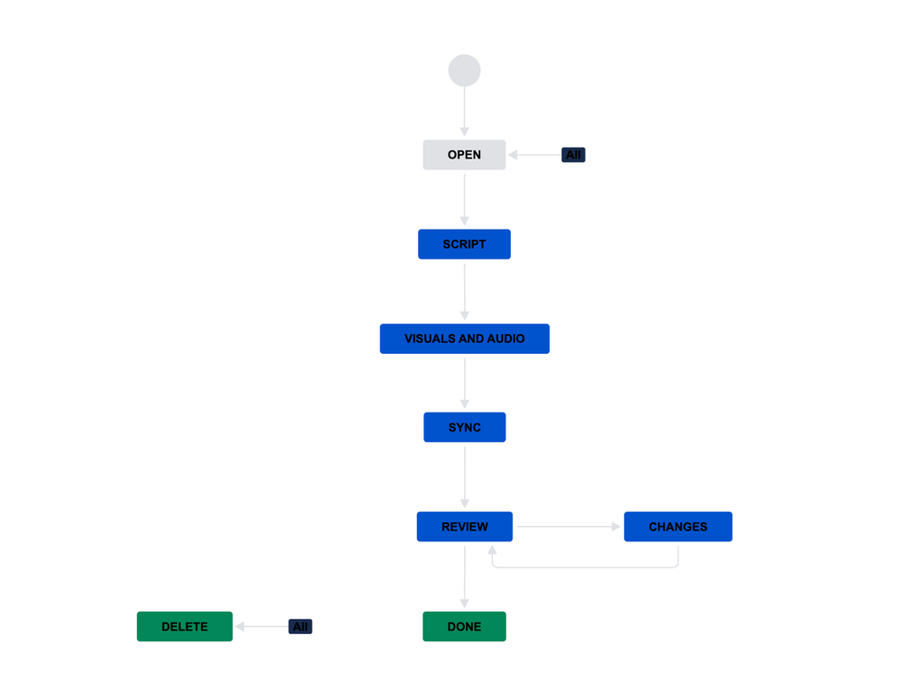

I have a workflow that uses unique status names to align with the work that my team does, eg "Script" and "Sync" (shown below)

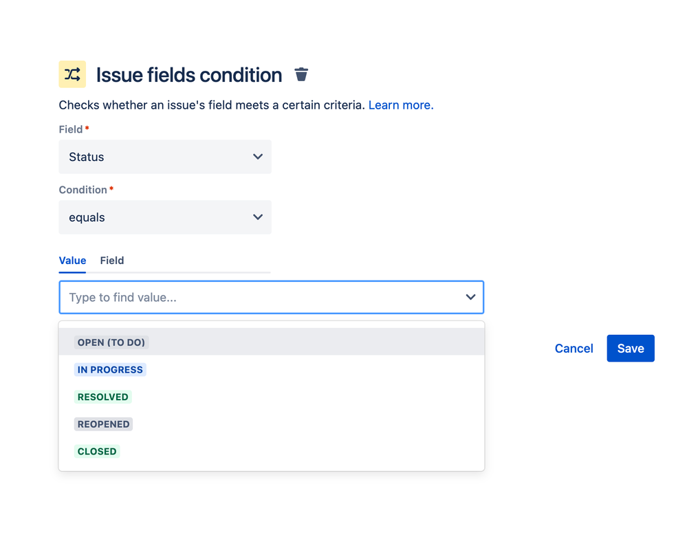

I am trying to make an automation rule that creates subtasks once the parent issue moves into a particular status. However, this does not appear to be possible? Only a handful of basic statuses are there?
Have I made a mistake, or is this a limitation of automation? If it isn't possible to use my custom statuses, what is the best solution? Creating a custom field that updates when the status changes and then using that as a trigger instead perhaps?

Hi @Hayley Rodgers
Is this a project or global/multi-project scoped rule?  Can the selected project see those status values?
Have you also checked the issue transitioned trigger to learn if it can see those status values?

With your help, I figured it out! This is a project rule and the custom statuses weren't showing up because I hadn't added my workflows to the project's workflow scheme (since I'm still editing them).
Thanks so much!
