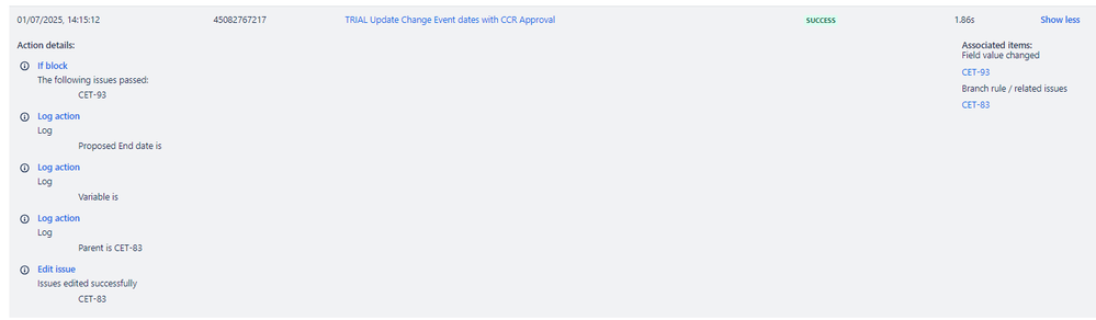

I'm really needing advice on automation rules here, I can't even get the log action to show me the value of a custom field..

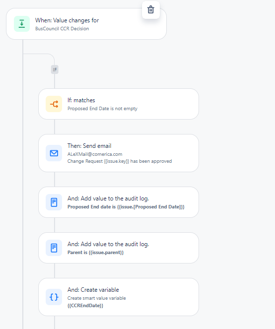

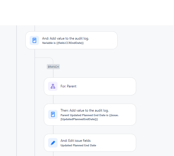

Here is the rule:
Here are the audit log results:

First thing, smart values are name, spacing, and case sensitive.  And, they often do not exactly match the displayed name of the field on the Jira pages.  When an incorrect smart value is used, it just returns as null / empty.
To identify the correct smart value (or custom field ID) for your field, please use this how-to article: https://support.atlassian.com/cloud-automation/docs/find-the-smart-value-for-a-field/
Next, when you branch to the parent to copy the field from the trigger issue, please use that smart value as the source.  For example:
{{triggerIssue.yourSmartValueName}}

Here are some simplified steps for that how-to article:
  • find an example issue which has your field, such as CET-93
  • with a new browser tab, enter this URL, substituting in your Jira URL and the issue key
yourJiraURL/rest/api/3/issue/yourIssueKey?expand=names
From what you describe, that would be this:
https://comerica.atlassian.net/rest/api/3/issue/CET-93?expand=names
  • after it loads, search on the page using the field name you know, such as with the Control-F and type in the field name
  • observe what you find...
    • the custom field ID should be on the left and the smart value will show the correct spacing / capitalization for the field
  • then try using the smart value or custom field ID in the write to the audit log to confirm the value:
    • {{issue.yourSmartValue}} or {{issue.customfield_12345}}
