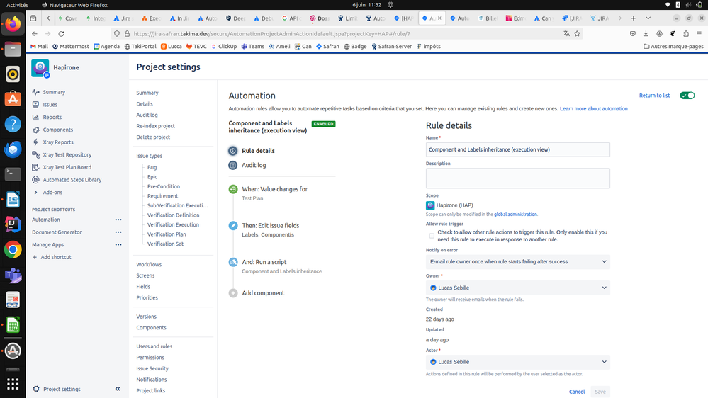

Hi,
I’m using Jira with the pluggin XRay. I tried to implement an automation rule to update the “labels” and “components” fields of a test execution whenever the execution is linked to a test plan. For that I’m using the field value changed trigger on the “test plan” attribute of the test execution. So when i add an execution to a test plan, it should be triggered. However, the rule is only triggered when I modify manually the field “test plan” in the test execution. but if i add the execution to the test plan from the test plan issue, then the rule is not triggered. Do you know why it is like that and how I could get the rule to works in both directions (from the test execution and from the test plan)

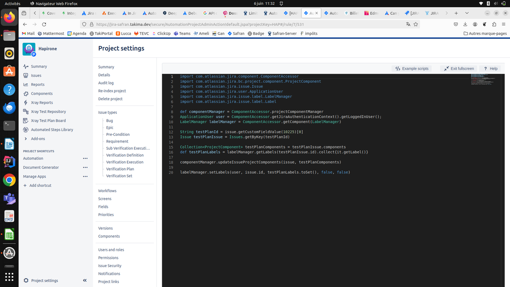

Capture d’écran du 2024-06-06 11-32-01.pngCapture d’écran du 2024-06-06 11-32-19.png
Here is an image of my complete automation rule with the script that I use.
I think the problem is probably like you said that the action performs by XRay is not considered as an event by Jira Automation, so  it does not trigger the rule.
