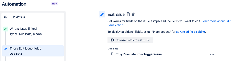

Hi @Shashank Vaishampayan
If I understood correct, you would like to set the Start Date of a parent issue based on its linked issue date. If my understanding is. correct, you can set up an automation similar to the below one:
This will allow you to copy the value from the linked issue.
Regards!
November 8, 2023
Hi @Eugenio Onofre , thanks for the quick response. I would like the start date of the linked issue to be the end date of the parent issue. So say Task 1 is the first issue having estimate as 2 days, start date as 8th November and end date as 9th November and Task 2 is the second issue which has estimate of 2 days and is supposed to be done after Task 1 is completed.
So in this case, what I am looking for is that if I link Task 2 to Task 1 saying that it has to be done after Task 1, then I want the rule to execute and mark the start date for Task 2 as 10th November since Task 1 is ending on 9th November and Task 2 can start only after that.
Hope I have been able to put my query across.
