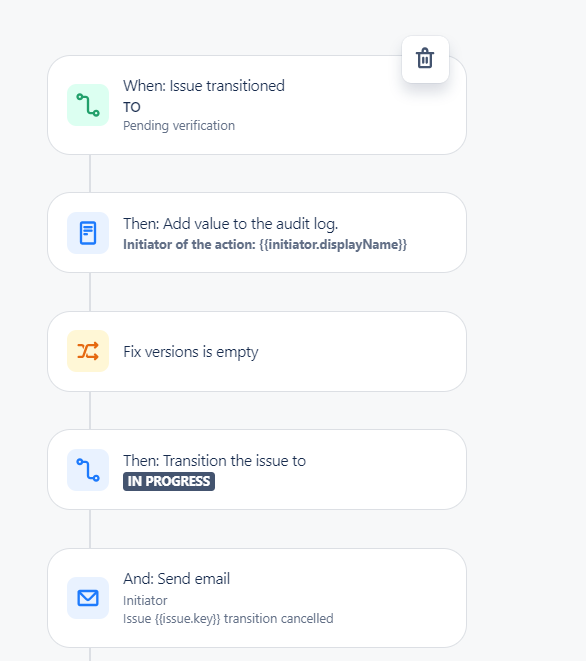

The complete rule below:
I added the first log element to see if this was related to who were doing the transition but it is not the case.
The step that fails is the "Transition issue to"
I'm pretty sure I'm missing something but I can't see what so any input would be appreciated

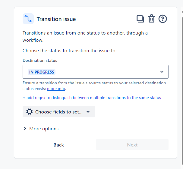

What does your workflow look like for the specific issue type involved?
For the Transition Issue action in the rule, did you add a filter on the transition name?

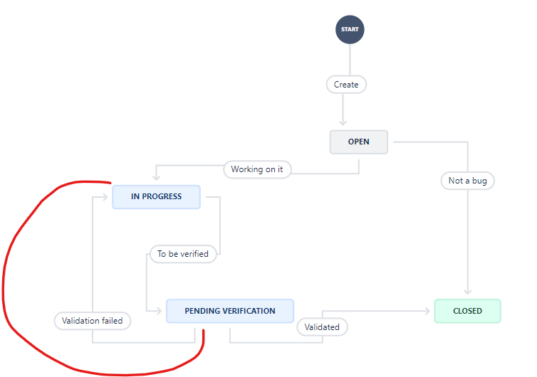

Regarding the workflow, it's a simple workflow. I didn't have any rules in it. I highlighted the transition that allow the change of the status by the Automation rule

Thanks for confirming the rule's transition action does not filter on the specific, named one.  (That can be done with the "add regex to distinguish..." option.)

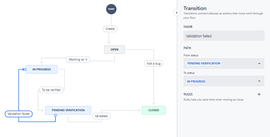

What happens in your named transition, "Validation failed"?  Please show that one.

I'm not sure to understand  what you want. I'm adding the screenshot of the transition by nothing has been configured

That was what I wanted to check; it shows no additional validation / checks on the transition.
