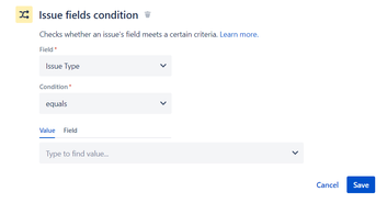

What is not working as you expect?  And, please post an image of the audit log details showing an execution of the rule to provide more context.
Also note in your rule, try using the Issue Fields Condition to check the Issue Type, rather than testing the Name attribute.

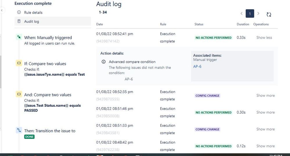

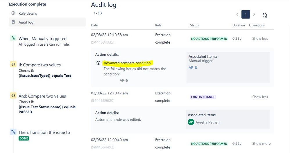

Thank you for the reply. Here is the Audit log. No errors but Issue of Test Type is not transitioned to Done even after changing as per your suggesion

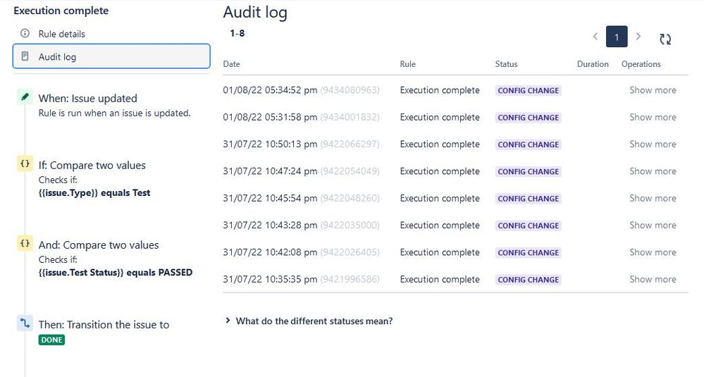

I see in the audit log that the rule is not triggering.  What event/change are you making that you are expecting the rule to run?

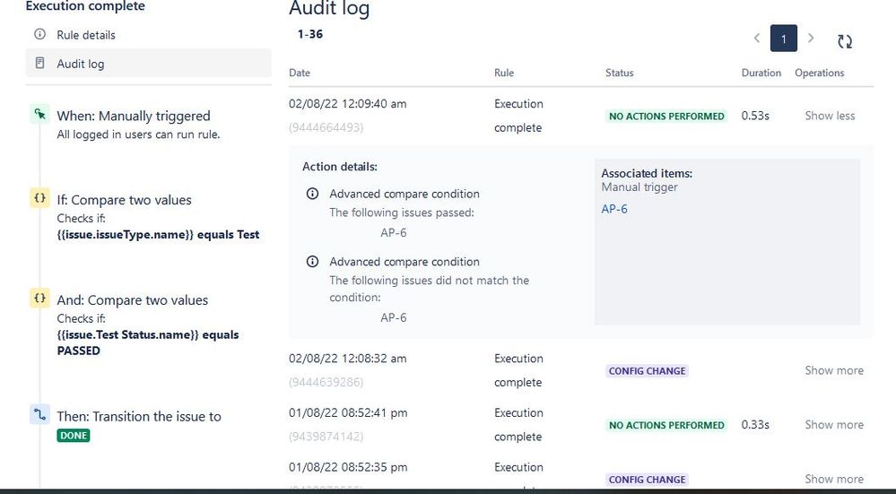

@Bill SheboyI even tried triggerrign it manually So the current rule is and its execution is:Audit log 2.JPG

Looking at that audit log image, it shows that the first compare on issueType.name did not match.  And, the field name of issueType is misspelled.  Unfortunately, the rule editor does not catch such types of errors.
Perhaps try changing to use the condition on just Issue Type, and not the name, as that will use dropdown lists to ensure you have the correct values.
Then we will be able to consider the next comparison's results.

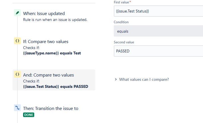

Apologies for the Typo. With correct name as well it is not performing any actions. Typo happened when I tried differrent cmbinations

Comparison for Issue Type
As I noted earlier, you should not need to match on the {{issue.issueType.name}}, but instead can just use the Issue Fields Condition.  The drop-down list for Value will show only valid values for the Issue Type.  If you type (e.g. Test) is not listed then it is not available in your project's scope.
Comparison for the Xray field
I suspect you have either the field name's smart value incorrect, the value incorrect, or both.  Smart values are case and spacing-sensitive, and if you have the incorrect value the rule will treat the value as null.

@Bill SheboyI gte now what you are saying. So I rectified rule it use Issue Fields Condition.  But I think the real problem lies with the secnd condition

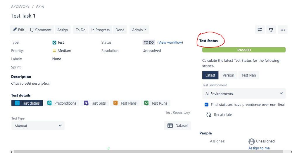

I used api to get the field names or smart value. But I do not see anything for Test Status. Though on issue itself I can see it
But REST API response has no description of teh x ray fields

Thanks, as that helps clarify things...Short answer: I do not believe what you are trying is possible without calling the Xray REST API.
It appears the Xray information is dynamically generated from calls to their product's REST API.  That seems to match the information in their documentation: https://docs.getxray.app/display/XRAYCLOUD/Taking+advantage+of+Jira+Cloud+built-in+automation+capabilities
And it matches this Atlassian Community Post, where the Xray team notes the smart values are not accessible directly, and only by calling their REST API:
https://community.atlassian.com/t5/Marketplace-Apps-Integrations/XRay-and-Automation-smart-values/qaq-p/1648050
