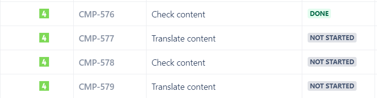

However, when one of the 2 new issues of type 4 Content & Translations is set to done it will automatically create these 2 issues again. The rules are runned again for these 2 new issues.

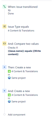

The rules look like the following.
The image below shows the list view and displays that the 2 issues are created again when one of both is set to done.

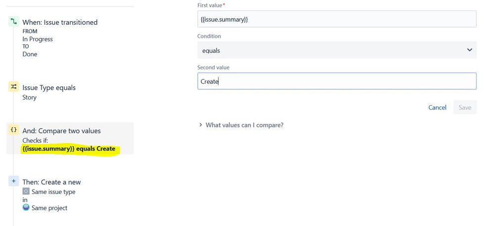

I think Write content issue should not be wrapped inside curly brackets. {{Write content issue}} -> this can be wrong. If you are comparing text it should be just Write content issue. For example in following condition if issue summary is equals to Create then it will create a new issue

2) Then this rule, as displayed below, is runned when the "Write content" issue is set to done:

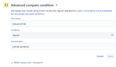

The advanced comparison condition looks as follows:

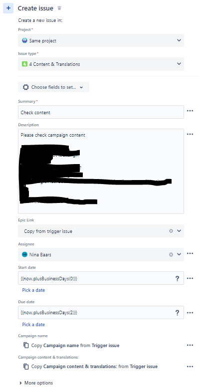

Example of one of these issues:

It does not appear you made the change that @Gokaraju gopi suggested for your condition, to compare {{issue.summary}} to the text Write content.
