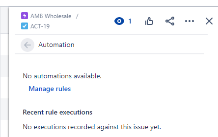

So I created a simple automation rule for re-occurring events. I just want the task to be re-created 1 month ahead after it transitions to "Done" but after creating the rule and publishing it, it cannot be attached to the task as you can see it says "No automations available". If I go inside Manage rules, I'll find them there but how can I link a rule to a task ?

Bill Sheboy
December 30, 2021
Hi @Bilal Khan -- Welcome to the Atlassian Community!
For a question like this, please consider posting images of your rule and the audit log.  That will provide context for the community to offer suggestions.  Thanks!
Until then, what is the trigger type for the rule?  Only rules with a Manual trigger show up in the list from the issue view.
For the use case you describe, I expect that the trigger is on Issue Transitioned rather than Manual.

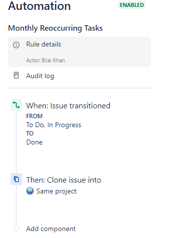

So here is the rule and what I want to do is figure out how to target the trigger. Creating a new rule asks for Trigger but no option to target specific issues.

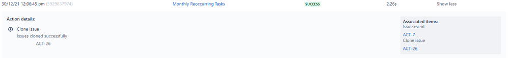

Here is the audit, I had created a new issue under another epic and closed one of the tasks to "done" and my rule triggered and that's when I found out what the problem was. So it works, just not the way I want it.
Bill Sheboy
December 30, 2021
Thanks for that information!
How do you know when you want the rule to run?  For example, is there a specific value in a specific field that you look for?
If so, you could add a condition after the trigger to check that field/value and then the rule would meet your use case.
