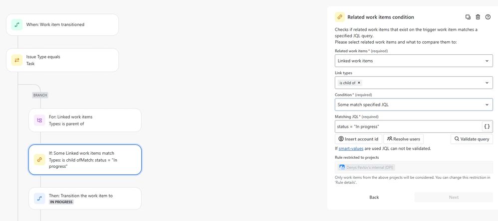

I'm trying to set up a rule for a Story that is linked with respective Tasks as "a parent of" so when at least one Task (that are linked "a child of" the Story) changes its working status to "In progress" the Story would inherit this status as well and become "In progress" too.
 I tried to configure this as shown on screenshot, but this rule doesn't work and I update the Task status to "In progress" the Story's status doesn't change.

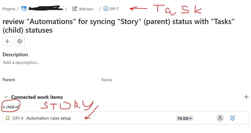

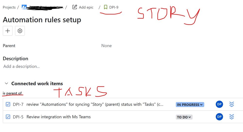

 I also attach screenshots of how the Story and Tasks linked.

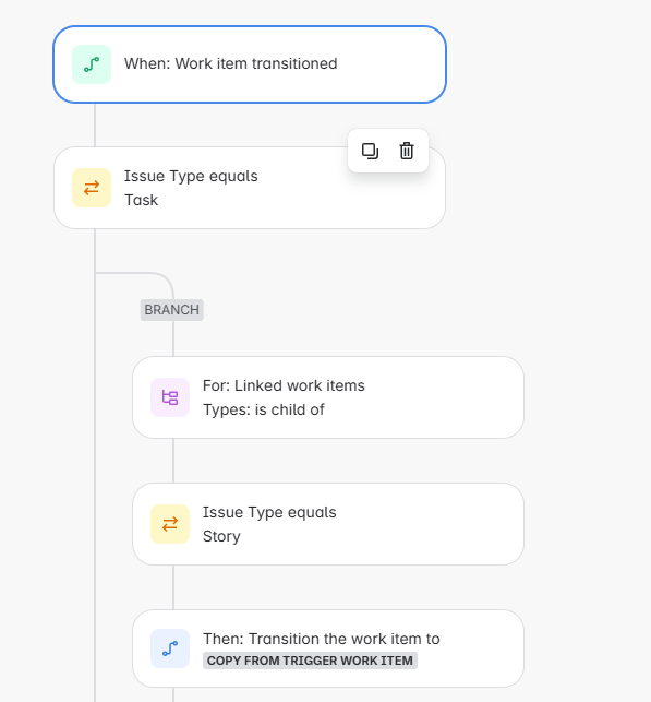

Hello @Denys Pavlov,
Thanks for reaching out to the Community!
The automation rule below will work for your scenario. Regardless of which status you move the task work item to, the story status will be inherited from the triggered work item.
Hope this helps!!
Thanks,
Archana
Denys Pavlov
July 30, 2025
Hi Archana, That really helped. Many thanks!

I'm a bit confused about what your automation rule is supposed to do.
If i read it correctly, It currently works as follows:
  • It's triggered when the "Task" changes status
  • The automation rule checks if it's indeed a "Task"
  • The automation rule will find the parent issues (Story) that are in status "In Progress"
  • It will change the status of the parent issues (Story) to "In progress" - This is because the "Transition" action is within the branch
I think your "Branch" is looking for the incorrect linked issues. Can you confirm that via the logs?

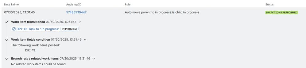

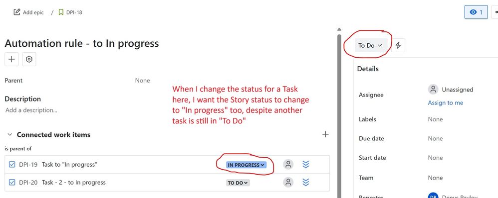

Denys Pavlov
July 30, 2025
Denys Pavlov
July 30, 2025
Hello,
thanks for speedy reply to my issue.
I include the logs for the rule. I see that it's not working, obviously. Can you please suggest any amendments to the rule?
Thank you.
Kris Dewachter
July 30, 2025
@Denys Pavlov ,
Something like this should work
Beware that offcourse this only works specifically for the ""In Progress" status. So the possibilities are limited to the transitions defined in your workflow.
