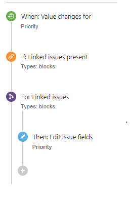

I believe the edit priority option is not set correctly in your rule. I tried in my server instance and the similar rule worked perfectly fine.
Can you check the edit priority option and send a screenshot? Attached are the screenshot from my instance.

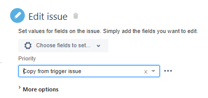

dwike_aprilia
February 21, 2022
Hi @[deleted] here is my screenshot from edit issue rule :
I thing we did the same way right? am I missing something here?
Yanty Ghani [ServiceRocket]
February 21, 2022
@[deleted]is correct, it's the setting for edit issue. You should select "Copy from Trigger issue" because you want to copy "Priority" from MIB to BMS.
dwike_aprilia
February 21, 2022
hi guys @[deleted] @Yanty Ghani [ServiceRocket] I've changed to trigger issue . But still facing the same issue here :'(

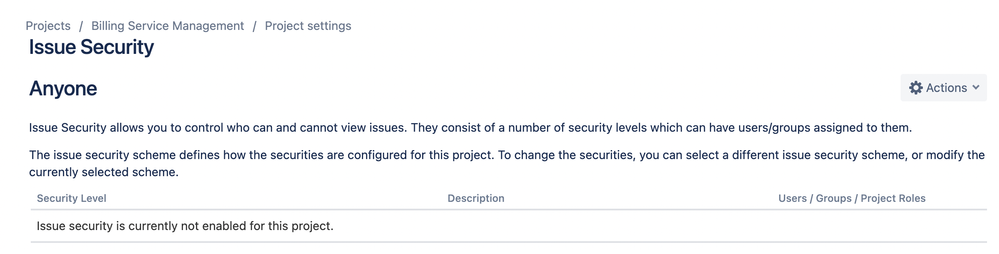

Hi @dwike_aprilia ,
Can you check if "Priority" field is in "Edit issue screen" in the JSM project? Also, check if there's any security level set in that JSM issue.
dwike_aprilia
February 21, 2022
@Yanty Ghani [ServiceRocket] yes, the priority field exists in every screen I used (View, create and edit).
the security level is not set as I attach below pic :(

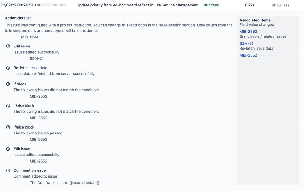

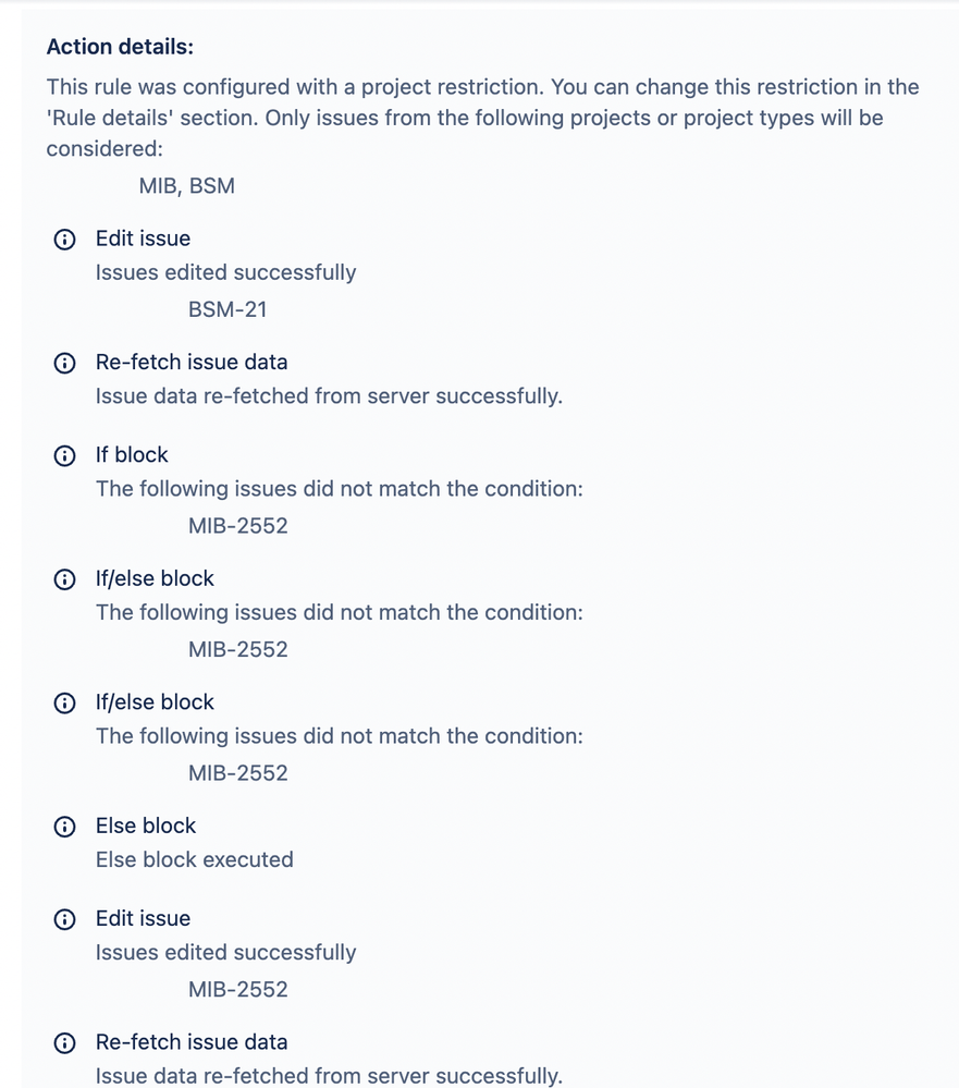

According to the Audit Log, it shows that BSM-21 was edited successfully after you updated issue in MIB, but you're saying the Priority fields are not the same for both issues, right? Can you take a full screenshot that includes this part:
dwike_aprilia
February 21, 2022
yes sure, here is the screenshot :
February 21, 2022

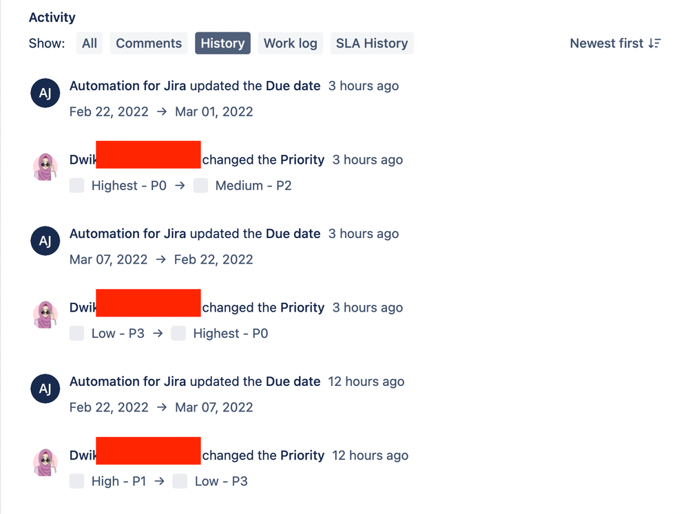

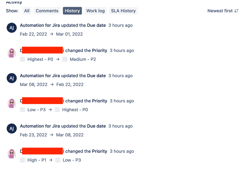

Ok, it shows success and issue BSM-21 was edited successfully. So doesn't seem like there's any issue. Can you take screenshots of issue history for both MIB-2552 and BSM-21? Make sure that it's sorted newest first.
dwike_aprilia
February 21, 2022
hi @Yanty Ghani [ServiceRocket] yes. the due date was updated for both tickets but not with the priority.
here is the screenshot from both history of the ticket.
BSM:
MIB :
