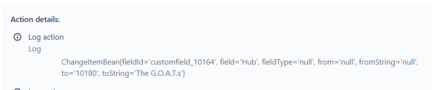

thanks for the reply! It logged this:
As far as I understand this, this looks fine (at least toString is not null...)

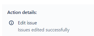

thanks for the reply. I checked the audit log, that's why I am confused. It says the following:
it also states the correct ID of the issue that triggered the rule by changing the field and the correct IDs of all issues withing the epic. Looks totally fine to me.

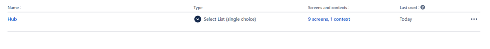

Do you have a screenshot of that custom field and type?
Hi @Dave Mathijs ,
I know about the "untouchable" fields, I really only updated the custom field I created.
Does the screenshot provide enough information?
