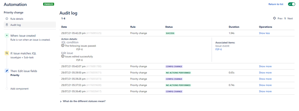

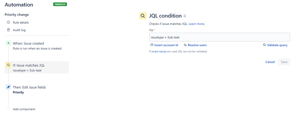

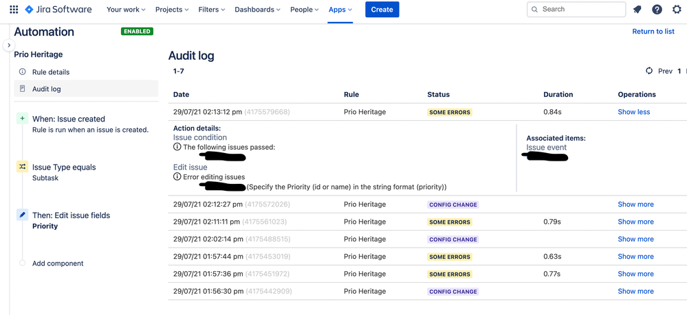

I created a rule to heritage Priority Levels of User Story's to related sub-tasks. It failed and I dont understood why. Please find the details below, fail log and rule itself.Ekran Resmi 2021-07-29 14.32.48.png

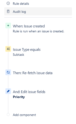

Hi @Efe Işıkyüzlü
is my understanding correct that it is not yet working for you?
In a team-managed project (I seem to have recognized you are using a tem-managed project) I was able to reproduce this problem - it looks like a timing-related issue and finally it was made working by the following fule (a re-fetch was brought in).
For completeness (as there seem to be several possibilities) the "Edit issue fields" action looks the following:
Regards,
Daniel
Efe Işıkyüzlü
August 3, 2021
Yes, this completely solved my problem, thank you very much.

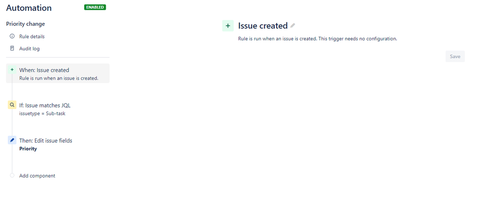

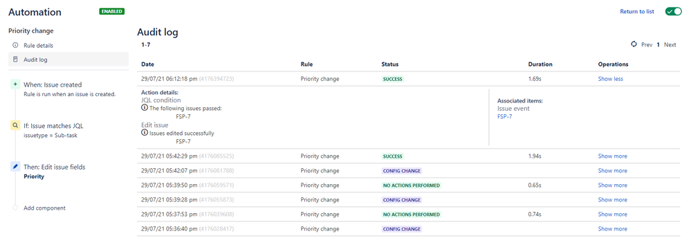

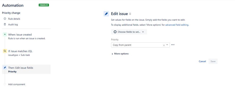

If you look at the above automation.
This is used to copy the priority from Parent(Story) to Sub-task.
You can set the default value for the priority in the actions.
Thanks

hi again, my aim is copy the priority from parent(story) to sub-task also. Default value is medium but i want like that: if i create a sub-task in a Highest level story, this sub-task should have highest in default.

Efe Işıkyüzlü
July 29, 2021
Could you understand why it failed then? What can I do to run it successfully?

Efe Işıkyüzlü
July 29, 2021
when i run, an error occurs in there. i did exactly same steps but there is an error, which i posted in the main question. i actually dont understand why.

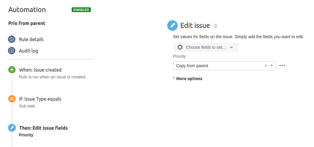

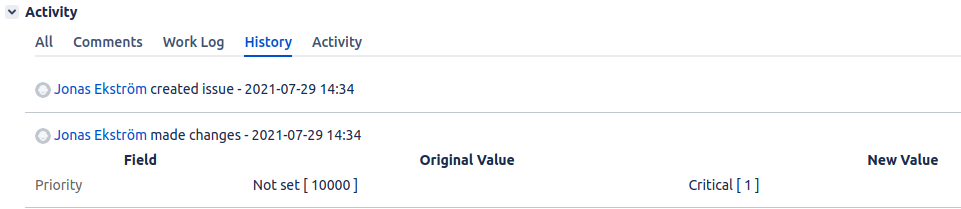

Jonas Ekström
July 29, 2021

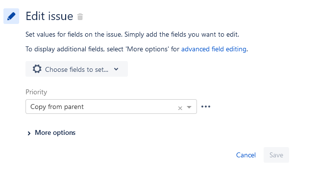

Does your edit section look like this? If you choose copy from parent, it should work

my edit section look exactly same with it. Could you run this rule in your environment? Does it success?

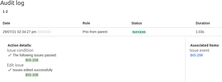

Jonas Ekström
July 29, 2021
It does indeed work without any issues

Hi @Efe Işıkyüzlü ,
according to the above screenshot.
You need to specify the field values
Thanks

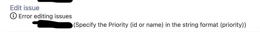

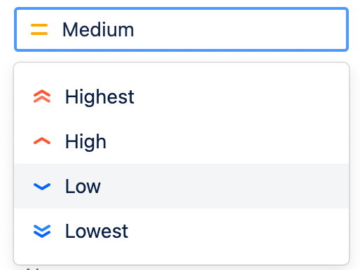

Efe Işıkyüzlü
July 29, 2021
first of all, thanks for your interest. It said that i need to fill it with a string but its a chosen value from drop-down list. How can I specify it?Ekran Resmi 2021-07-29 14.57.21.png
