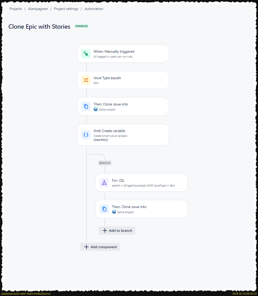

I want to clone an Epic with all children and have set up an automation rule.
The rule clones the Epic first, but fails to find all children of the Epic to cloning them as well.
I probably have a misunderstanding of the rules that I use.

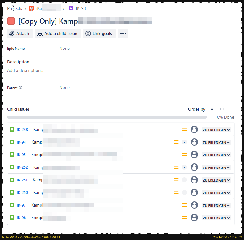

Here is the Epic that I would like to clone:
Here is the ruleset:

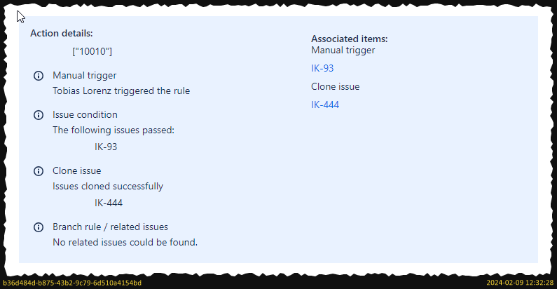

And here is my automation log:

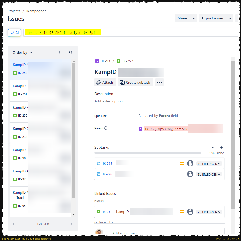

I also tried using various JQL queries, but this was not successful either.
Using JQL in the UI to search for children of this Epic works perfectly,

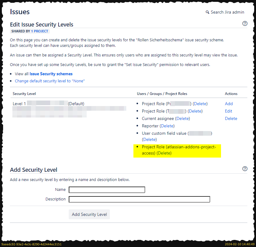

My research revealed, that the culprit here was the configured Issue Security schema on the Project.
Not only does the Project Role (atlassian-addons-project-access) need access to the project permissions. There also needs to be an Issue Security Level with this Project Role assigned, if Issue Level Security is used on a project.

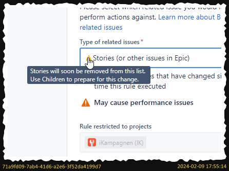

Please try changing the branch type, from "Children" to "Stories (or other issues in Epic)"

Hi @Bill Sheboy, thanks for your suggestion.

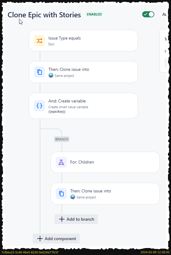

I already tried this branch type, but the result is/was the same. No child issues were cloned.
I then changed the branch type to "children", as recommended by the automation UI.

This seems to indicate the Parent field is not found correctly for those issues.  Let's test that hypothesis:
Change the branch to JQL, with this:
parent = {{triggerIssue.key}} AND issueType != Epic

Unfortunately, even if I change the branch to JQL with your suggested query, the automation still fails to find children of the Epic to clone.
If I use this very JQL to filter issues in the issues screen, the JQL works as expected. All 8 children are found. In the automation, they are not.

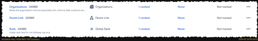

And, please check your custom fields to determine if there are multiple fields named Parent. You can ignore the one named "Parent Link" if you see it; we are checking for "Parent".  I believe the built-in one will not display in the list of custom fields, and so if you see a field there may be a duplicate field causing problems.

There is no other parent field that we added to our instance.

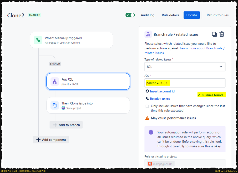

Here is a full screenshot of the automation
As far as I understand it, my setup is not very complex, and so isn't the automation. There is no apparent reason for it not to work as expected, yet it doesn't.

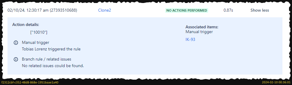

Disabling and re-enabling it didn't help.
I will re-create the automation and try again my tomorrow.

For a quick verification I created a new very simple automation to just clone this precise Epic's children.
The JQL verification in the automation creation UI says there are 8 issues.
Yet, the automation does not find them

I checked the permission scheme for the project, and the Project Role (atlassian-addons-project-access) does have every Permission on the project.
Tobias Lorenz
February 10, 2024
I found the solution. See my answer.

As you can see in the automation log, it runs, but doesn't find very well existing children of the automation.
