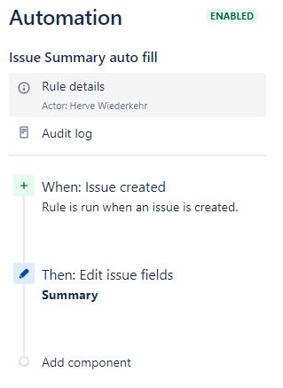

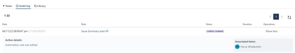

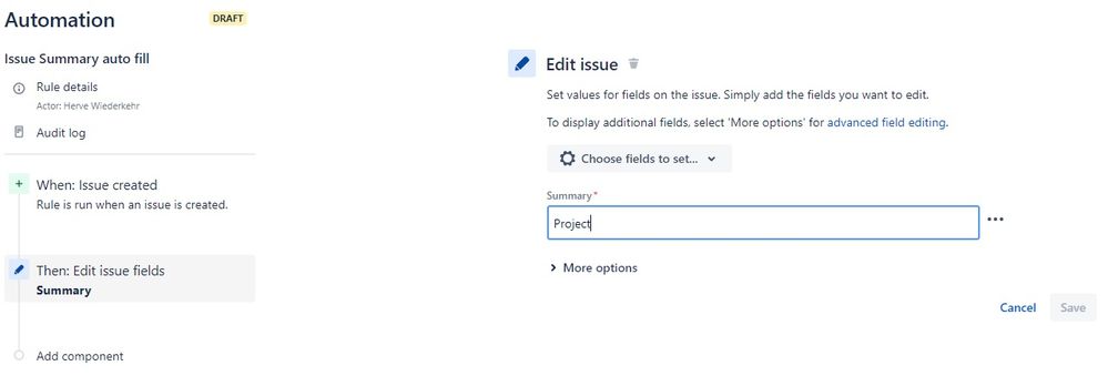

Herve Wiederkehr
November 4, 2022
Hello,
Here is the screenshot after editing then executing (nothing happens) but no trace in the logAudit Log.jpg
Bill Sheboy
November 4, 2022
Hi @Herve Wiederkehr
What problem are you trying to solve by doing this?  Knowing that may help the community to offer suggestions.  Thanks!
From what you have described thus fare, what do you want to accomplish:
  1. have a default value of the word "Project" when an issue is created
  2. add the word "Project" to the beginning of an existing issue summary
#1 cannot be done with an automation rule.  Rules are triggered after an event has occurred, such as Issue Created.  If you ant a default value, you will need to use another method.
#2 can be done by changing your field edit to be the following, adding the existing summary after the word.
Project {{issue.summary}}

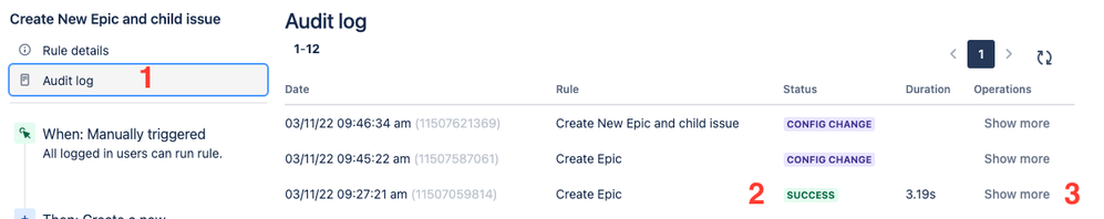

Trudy P Claspill
November 4, 2022
@Herve Wiederkehr
Can you also share the Audit Log for an execution of the rule?
1. Click on Audit Log above the rule components.
2. Find an execution that says "Success" in the Status column.
3. Click on "Show more" to the right of that.
4. Provide a screen image of all the messages revealed.

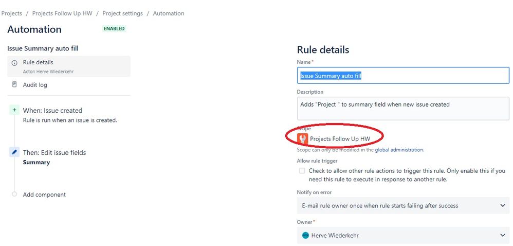

Trudy P Claspill
November 4, 2022
Hello @Herve Wiederkehr
The absence of an entry in the Audit Log for the rule means it was not even triggered.
It appears that the rule is turned on, as it say "Enabled" next to the rule name.
In the Rule Details, what is specified for Scope? This should list the project(s) against which the rule will run. The rule is triggered by creation of an issue in the specified project(s). Has an issue been created in the specified project?
Herve Wiederkehr
November 5, 2022
Hello,
Thank you for your answer.
The scope for this automation is the project "Project Follow Up HW" (See screenshot attached).
As the even isn't fired as was wondering if it could be related to my browser config (Chrome) related to javascript or even my antivirus?
Kind Regards
Trudy P Claspill
November 6, 2022
It is unlikely this is related to your browser config, javascript, or your antivirus.
@Bill Sheboy provided an explanation about how the Issue Created trigger works. You have to create the issue and click the Save button in order for this rule to be triggered and execute. The rule will be triggered only after you initially save the new issue.

Herve Wiederkehr
November 4, 2022
Hello,
Thank you for your prompt reply.
Please find the screenshot of the role hereafter.
Kind Regards
Hervé
Herve Wiederkehr
November 4, 2022
