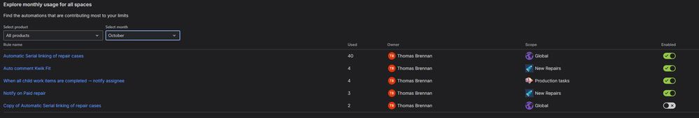

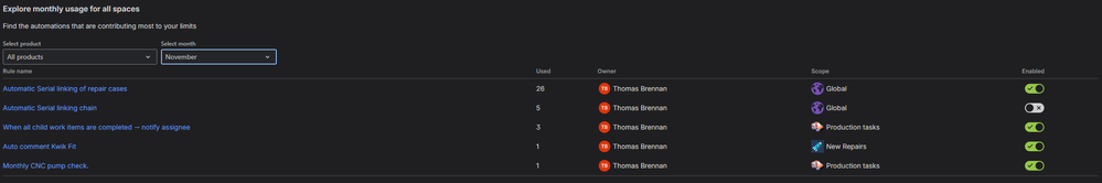

Had a couple of automations not run this month, saying they had been aborted due to "exceeding automation limit". However, when I look at usage there has only been 2 of our automations used of our total 1700. Typically a month we may run about 50 so I've not seen an issue like this before. Nothing has been changed with the automations in months and they never have an Issue running correctly.

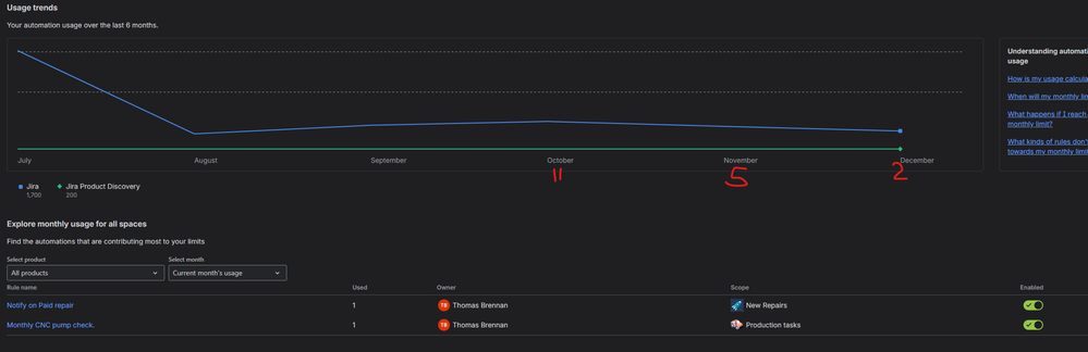

When I looked at the usage chart it was displaying that the past couple of months have had very few automations, (5 & 11 for November and October). Underneath that if I select the the month I get the correct number of uses.
Am I missing something obvious or might there be something wrong? has anything changed recently with Jira and/or automations that may affect this?

Upon reviewing the current setup, I noticed that the automation rule "Notify *******" has been aborted with the reason: "Monthly rule executions have been exceeded." Similarly, the automation rule “ “ has been aborted for the same reason. However, the current automation usage is only at 1%.
This issue may arise when a site has a previously issued license that has expired or is no longer valid. For instance, if a site had both Jira and Jira Service Management (JSM) and JSM was subsequently removed, a rule with a global scope will still check for both licenses. If a valid license for JSM is not found, it can trigger an error. I observed that JSM was removed from the site on December 02, 2025, which might be contributing to this issue.
To address this, could you please adjust the scope of the automation rules "Notify *******" and “Automatic Serial linking of repair cases“ to multiple spaces instead of Global? Please select all relevant spaces and see if this resolves the issue.

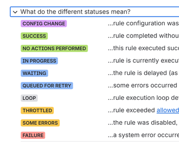

There is uncertainty around this ABORTED status.  There are monthly usage limits and separate service limits, only two of which are covered by the other status values.  Perhaps that is one of the reasons it is not listed under What do the different statuses mean?
