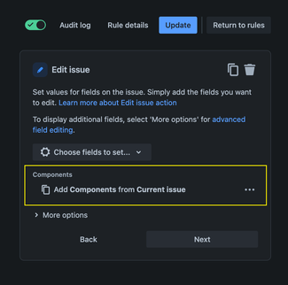

I want the epic's component to be added to the issue's component list, not overwrite any other components the issue was already tagged with upon creation. The documentation has steps for this, called "adding values to multi-select fields." It should work in theory, but I don't have the ability to do what the instructions say.
Instead, in my version of Jira, if I use the "copy from issue" function (called "Add components from current issue"), I lose the ability to add anything else to the field. So I can't add a second component like the instructions state I should be able to. Screenshot attached of what I see.

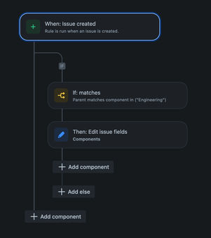

Appreciate your response. Attaching my flow JIC.
I see what you are suggesting in your bullets, but that's mainly what I have. Except for the re-fetch action. Do you think that would cause my automation UI to change?
Just to phrase my question a different way: I am not saying my automation rule is not working, I am saying the Jira Automation UI I am seeing that allows me to configure rules doesn't match what the documentation screenshots are showing.

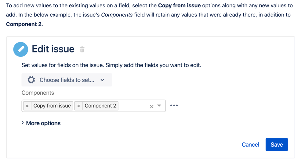

Supposedly after you select "add components from parents issue" as you and I write above, you should be able to add other components manually, as in: type them in as a list. And in my browser, I don't have the box at all. I can type in either manual component names OR "add components from parents issue." Not both.
Do you see the option on your end to add manual component names like the documentation shows here?

For the UI differences, I wonder if that is both the browser / operating system differences, and changes to automation over time.  The documentation does not always keep up with the product improvements :^)
I recommend adding the re-fetch to prevent / reduce the changes of any unexpected rule behavior with that Issue Created trigger.
When changing the Components field with the built-in editor, you are correct that you may either set the values (with add / remove) or copy them from some other issue...but not both at once. A work-around if you want to do both is to edit using advanced edit with JSON, as described here: https://support.atlassian.com/cloud-automation/docs/advanced-field-editing-using-json/#Components
You can directly enter the Components when using the SET option; that will then show the drop-down list as in your image from the documentation.
