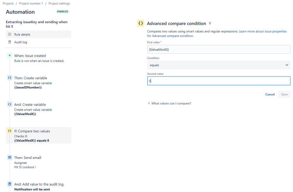

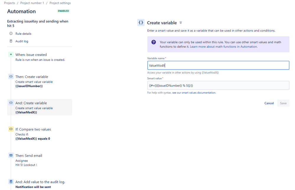

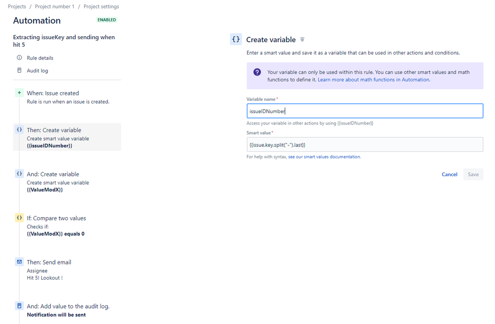

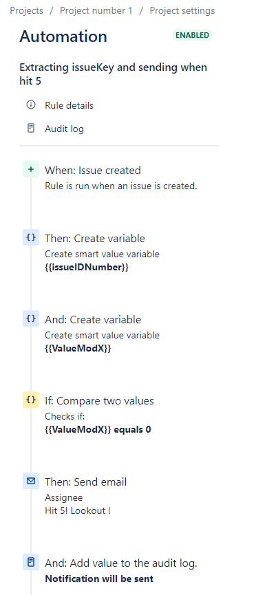

Hi Ketevan,
This could be achieved also with Automation, I am sending an example to notify when the mark of issues is hit.
What I do in the script is:
  • Extract the number from the Issue key that was just created and added into a smartvalue.
  • Divide the extracted issue key using the MOD function which returns the spare of a division, giving as a result 0 if the issue can be exactly divided by 5, in your case is 20.
  • If the result of the MOD division is 0, then send the notification.
Here are images of explaining the automation rule.
Indeed this problem could be solved with ScriptRunner as well, but that would require buying a plugin a probably more programming than it needs to be.
Hopefully this can help you and you can mark it is an answer.
If you have any questions, just let me know.

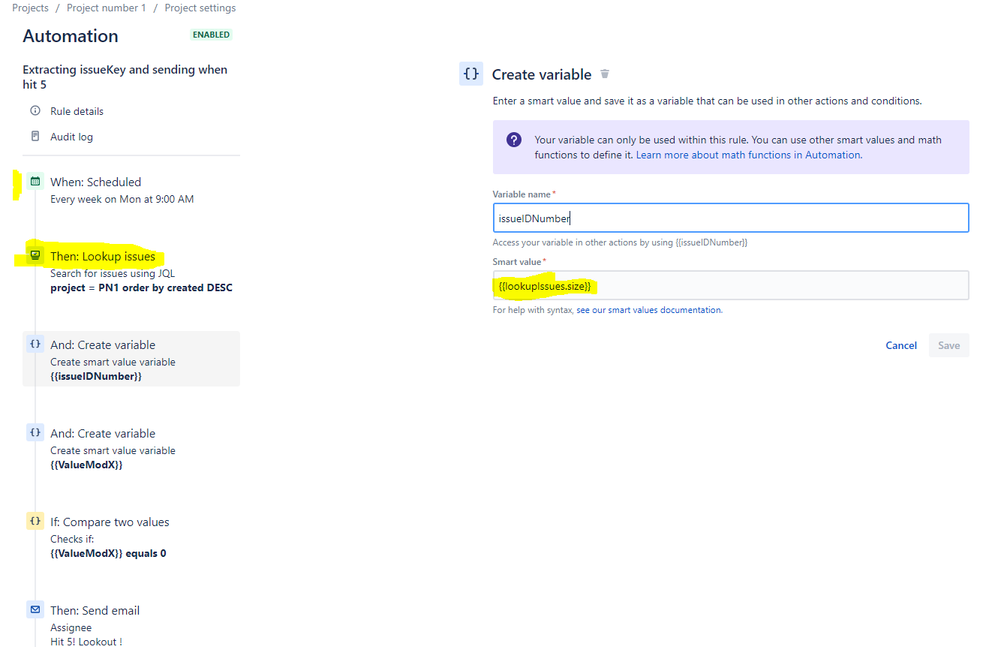

David Freitez
June 6, 2022
Hi @Ketevan
As was pointed out, we cannot rely on extracting issue key number to check on how many issues has been created if there are issues that were deleted. So, in that particular case:
I have updated the rule so it uses the Lookup Issues feature that uses a JQL that gives as result all issues of the project, then we'll grab with the smartvalue the result amount of the query and that's the value we'll end up dividing using the MOD function, the rest of the rule is the same.
If you have any questions regarding the implementation, just let me know.

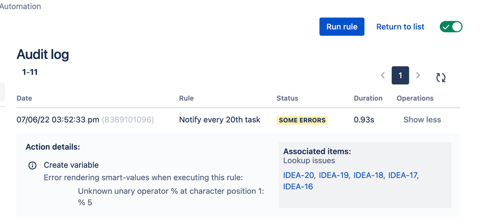

Ketevan
June 7, 2022
Hello guys,
Many thanks for helping.
@David Freitez I've tried everything according to your screens, but when I run the rule it fails, here is the log:
Do you know how to solve this?
David Freitez
June 7, 2022
Hi @Ketevan
Are you using the rule with the JQL or extracting the number from the Issue key ?
Can you share the screenshot of the % operator being used ?
Thanks,
David
