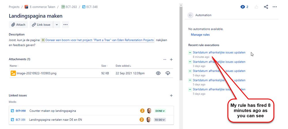

I see that it fires, but no changes occur.

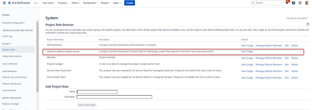

Many of the threads with potential answers were written a long time ago and screenshots no longer resemble current screens. But many users seemed to have an issue with assigning the atlassian-addons-project-access role to the project.
So I can see the role in the system:
And I can make the role owner and actor of my automation rules

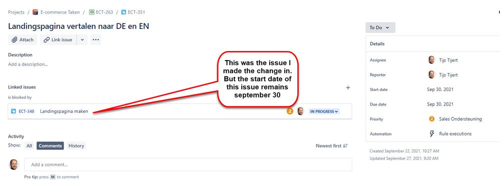

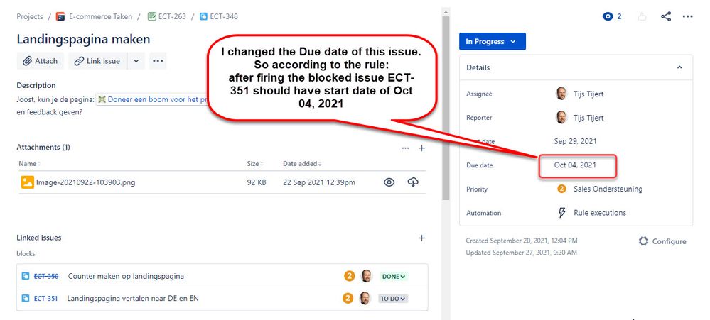

But somehow, when I perform the action that should fire the rule, the rule gets fired but nothing changes. It should change the start date of a "blocked" issue when I change the due date of the related "blocked by" issue.
Can someone help me?

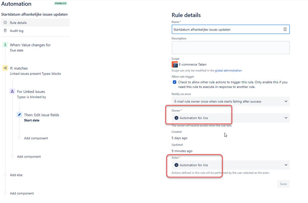

I have changed the owner to myself, changed the setting so that I get informed whenever the rule fails and tried again... I got no email, the rule triggered, but no start dates on other issues where modified.
Attached is a listing of the complete rule settings. I have tried to find where to get a rule log entry, but don't know.

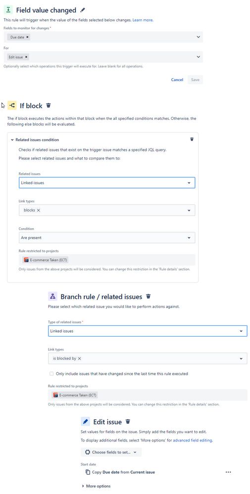

I note that the direction of the "blocking" in your condition and your branch are different.  Is that intentional?
And, if you check your audit log, that may make it more clear where the processing is stopping.

About your remark about the blocking direction.... I assumed that would be needed this way, because the original issue has a link of the type "blocks".
But when you open the related issue, you see the same link, but now with type: "Blocked by"... I will try to set the same direction on both and see what's happening.

Succes! That was it! I think it's a bit dubious from a logical point of view, but my rule fired successfully after I changed the "Blocked by" to "Blocked" in my branche.
