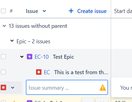

Hi, @Anna - it's not triggering because an issue created in a Plan doesn't actually exist in Jira until you use the Review Changes button and then Save Selected Changes in Jira. This is true for any change you make to existing tickets in a Plan as well, so if your issue trigger was Issue Edited, you'd need to apply the changes before that would occur.
Here's a new ticket created in a plan; you can see that it has an issue key (EC) but no actual number.
2023-03-13 14_17_46-Esther's Test Plan - Advanced Roadmaps - The Jira of Champions - Brave.png

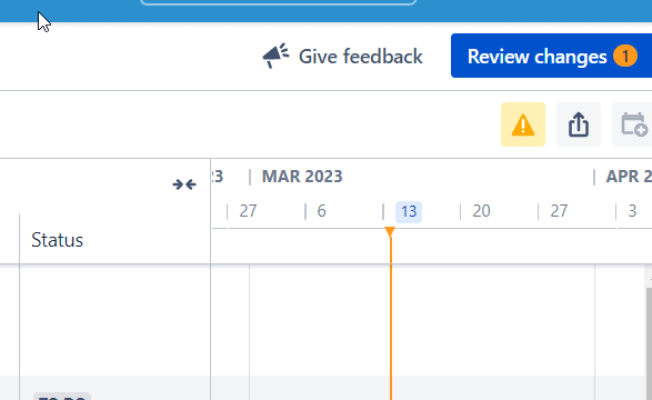

Click the Review Changes button at the top right:
2023-03-13 14_21_49-Esther's Test Plan - Advanced Roadmaps - The Jira of Champions - Brave.png

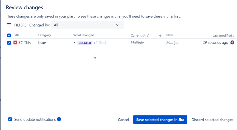

Then the Save Selected Changes in Jira button:
2023-03-13 14_17_59-Esther's Test Plan - Advanced Roadmaps - The Jira of Champions - Brave.png
This will cause your rule to trigger.
