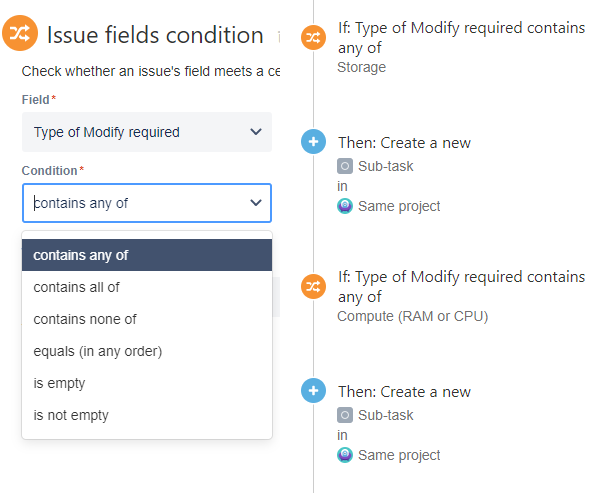

Dawid Joshua _TechTime_
January 5, 2023
What @Bill Sheboy says. Let me just add a note or two.
  • Both conditions should be "contains any of".
  • Instead of the action "Create issue", you could use "Create sub-task".
  • As Sub-tasks can't be created for Epic-level issues, add a condition to exclude Epics. This will prevent errors. you don't need this if you already filter them out in your trigger step.
