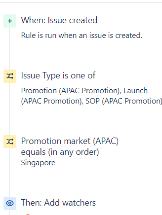

Hi @Nagarjuna Busireddypally
You posted an image for your rule for issue create and not the rule for the change to the Business Line field.  Would you please post an image of that complete rule?  Thanks!

This is the second rule which created

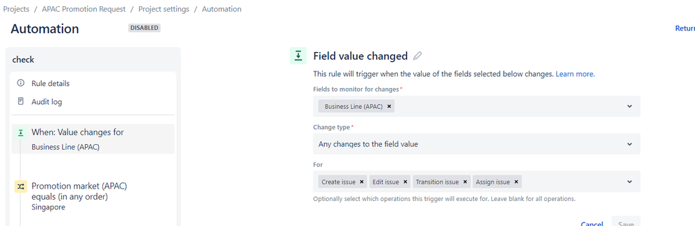

Below are the rules for field value changed
Thank you

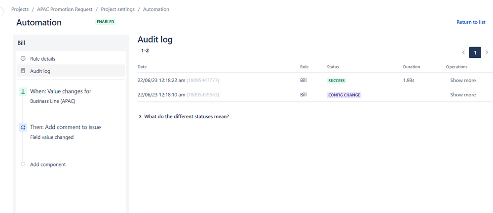

June 21, 2023
Hello @Bill Sheboy
Thank you for your email.
I have tried the below and it is working.
What should we try next to achieve our original request

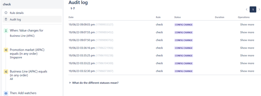

Hello @Bill Sheboy
Tried changing the rule as below and then it stopped working
Thank you

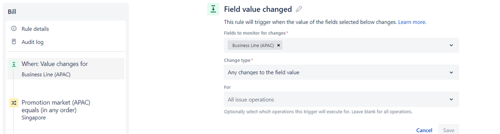

Did you change the trigger or leave it to run on all changes to the field?
June 22, 2023
@Bill Sheboy I just leave it to run on all changes, below is the screenshotb3.png

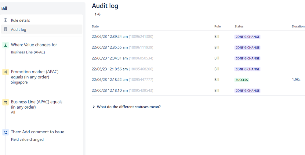

Are there any hints in the audit logs for the automation rule?
June 19, 2023
