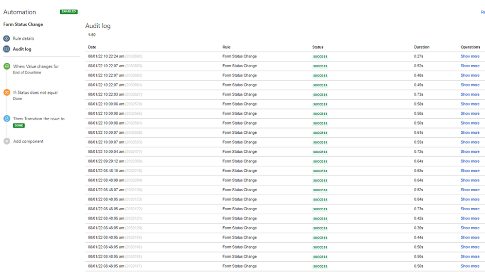

Nothing else I’ve seen has changed in the system. I am wondering if I should schedule a system restart to see if things get better. Here is a screenshot of one of the automation logs. See the times repeating, all the automations are doing the same thing. I’ll have several similar automations not related to this project all kick off at the same time. The 10:00AM trigger is a good example, the first one should have triggered at 9:49, instead automation is batching them.  All  automations executed  at 10 instead after the last window, regardless of the automation and what project it is in.

Sorry A4J is just my shorthand for Automation for Jira. A4J is integrated in Cloud but an addon for Server. In looking at your image that is what you have. The execution times are very minimal/reasonable. So if you look at the history of an issue to assess the time of the event that will trigger the rule and compare that to your rule trigger in the audit log you are seeing these long delays? If so it might be interesting to restart services and assess.
