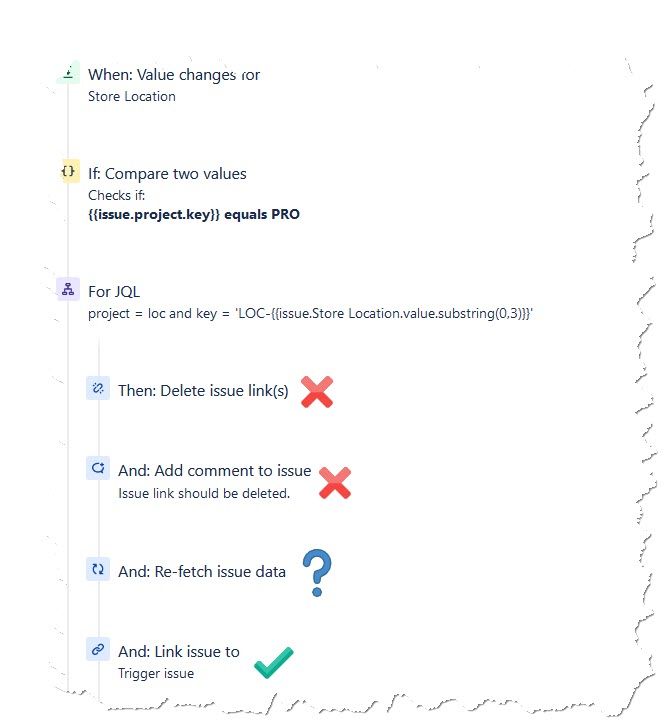

I have a simple automation that should delete all issue links on an issue after a field change event and then apply a new issue link.

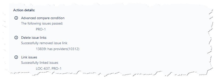

The Audit Log reports successful deletion, but the previous issue links remain and the new one is just added to the list.
Here is the Automation rule:
The outcome (according to the log) is successful. However, the comment IS NOT added and the issue links ARE NOT removed. The only thing that does happen is the new issue link is added to the list.
EDIT: Updated the screenshot to show what actions are not working vs working.
Figured it out. Once I moved the Delete Issue Links and Comment actions above the JQL, it all worked as expected.

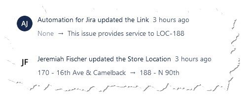

The issue in question prior to execution has (let's say) two linking issues on it. I change a value in a field that triggers the automation. The automation should remove all links and then add a new one based on the JQL. The outcome is nothing is removed and the new link is added.
I updated my post to include the automation rule.

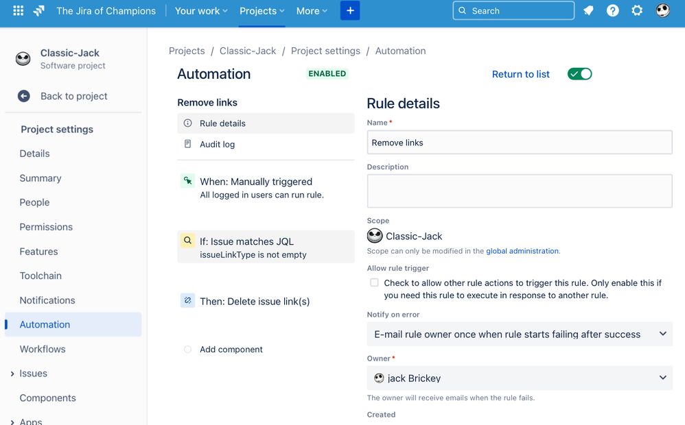

Hi @Jeremiah ,

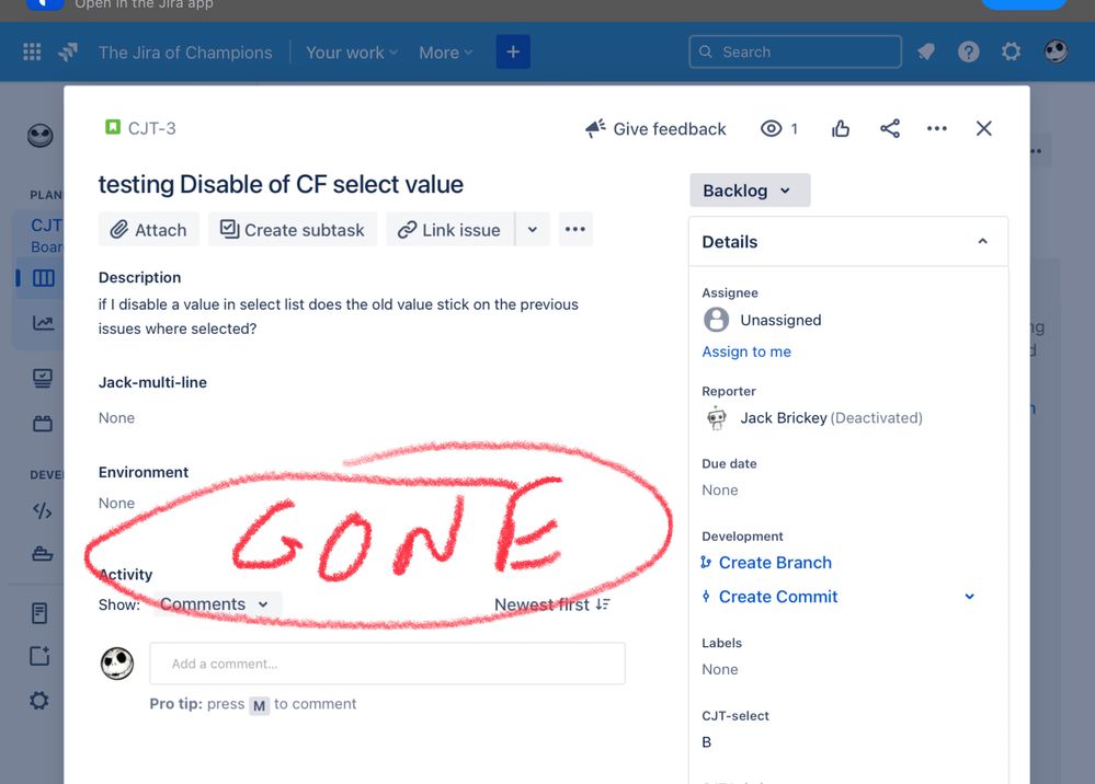

I did a quick test of the following rule. Below that you will see the pre-run and post run images. This worked for me. Note the condition is not required just something I threw in there.
sooooo.... now to figure out where your's is failing. A couple of suggestions to test;

Yes. It simply shows my edit of the field that triggers the automation, then it shows the automation updated the link. Nothing else.
