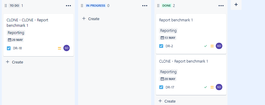

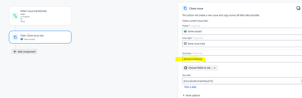

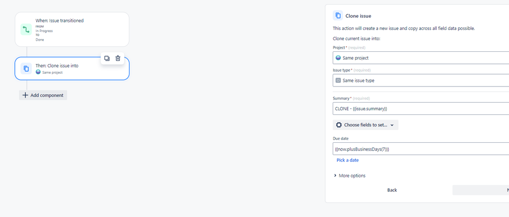

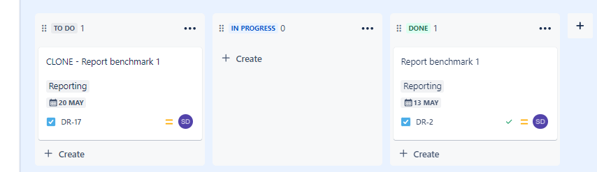

No using above. So I added screenshots and the 7 days is being added to the first clone but not the second. Its taking same date from main task still and adding the 7 and not from the 20th on the clone making the new clone 7 days later. Also, task name keeps appending CLONE to the new CLONES how do I stop that...thanksclone1.PNGclone2.PNG

I would advise using the automation in your screenshot, rather than what you are using now. If you'd like help troubleshooting what you are using now, please add detail or screenshots of the actual workflow, it's impossible to guess what's happening just from the results :)
In the automation you posted above, you can modify the Summary field so it doesn't add CLONE each time.

Hello, I am using the first screenshot trigger, the output above is the result of that trigger.
Steve Dillon
May 9, 2024
This works by remove the CLONE at start of summary, would be good if I can add an appending 2 for clone 2, 3 for clone 3...and so on? Also I think the trigger applies to all tasks, if I wanted different Due Dates would I use the add a branch.
