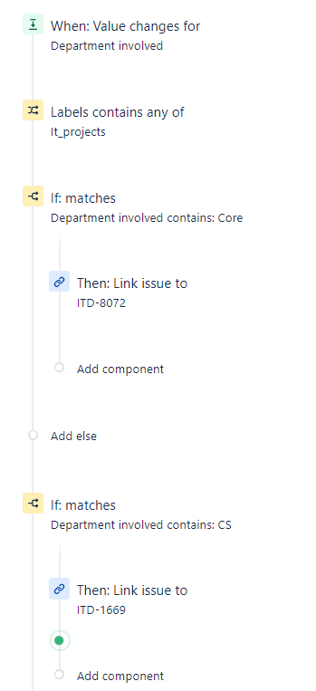

Hi,

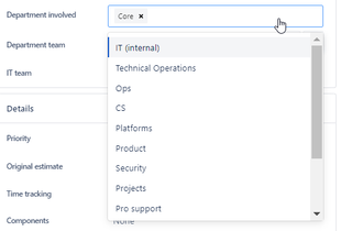

I have a costume field called "Department involved" (multi select field)
I'm building an automation to link tasks to different epics according to the field value.
For example - if the field is selected with "Finance", the issue should link to the specific epic I have for Finance department.
Additionally, the field is multi select since the issue can be related to several departments.
Therefore, for example if the field is selected with both "Finance" & "Legal" - the issue should link to both Finance and legal specific epics I have for each of the departments.
I'm not able to build the automation correctly because if I'm using "If" - the role stops running once one of the departments is chosen (if I have more than 1 departments the issue will link to the first one only)
I tried using field condition only but the automation changes nothing.
Would love for some advice here :)

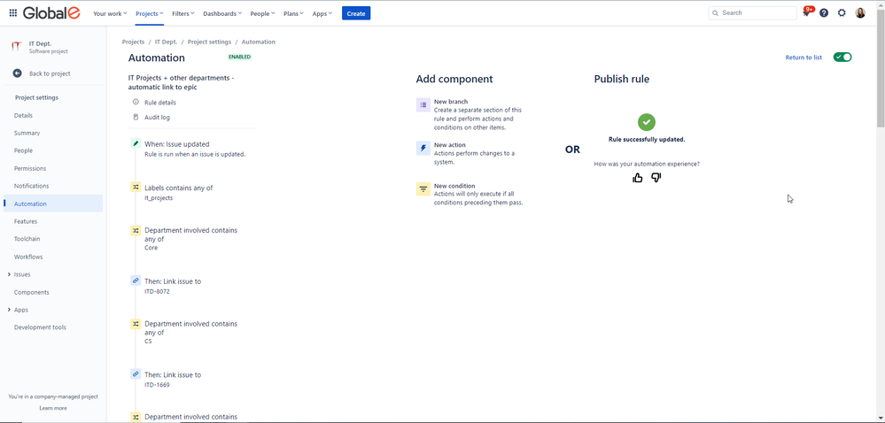

Hi @Bill Sheboy , thanks.
The epics are already created - I opened a specific epic for each department.
I want the automation to link the issue to the correct epic according to the option selected in the field "Department involved"123.png
The problem I'm having with the automation is that once more than 1 option is selected in this field - the automation links the issue only to the relevant epic for the first option. The rule stops from running after the first option is true in the condition.

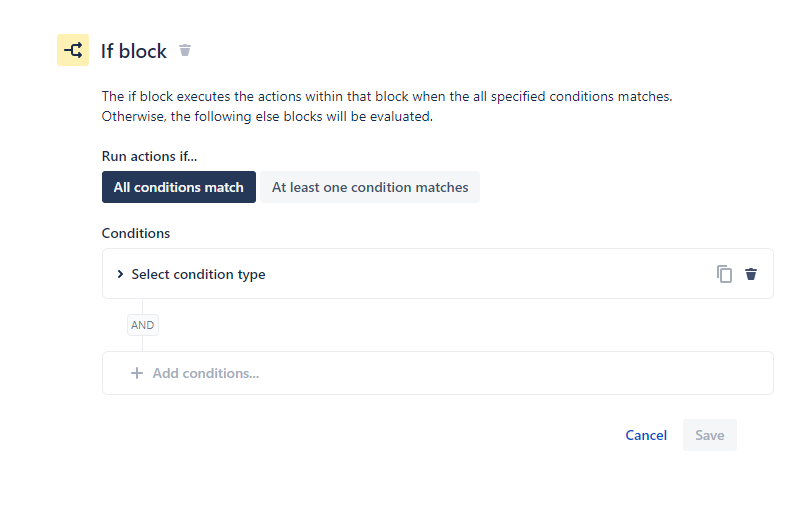

Vamsi Kandala
December 20, 2022
Hi @Dana.Harel
The 'if/else' block has additional feature to check if all conditions have to match or at least one condition.
Hope this helps.
Thanks,
Vamsi
