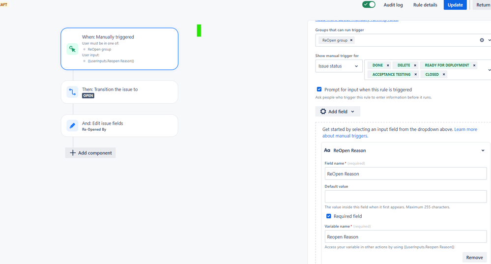

Hi Team.
I've created automation (as seen in the screenshot)
Automation has created a new screen "Reopen reason"
is it possible to find this field to add it to the issue view once it is filled? Screenshot 2024-03-27 103930.png

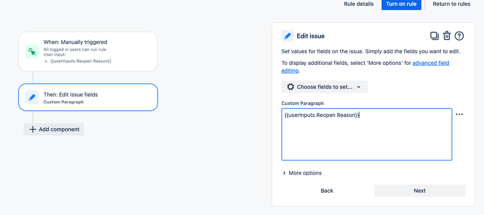

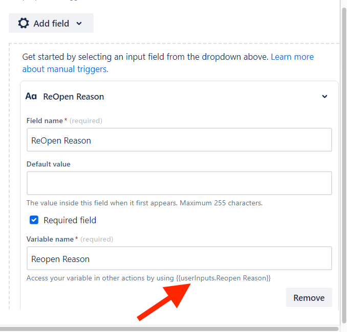

You can copy the information from the input field in the trigger to a field in the issue by using the Smart Value for the input field. The smart value for the input field is shown in the trigger configuration.
To set an issue field to a smart value, in the Edit action select the field, and then type in the smart value into the Value field.
Arturs Kalnins
March 28, 2024
Hey that worked Like a charm!

Hi @Arturs Kalnins ,
Yes this is visible to ReOpen group. But not sure why you need this automation. Better way is to add post function in workflow. where you update the the Re-Opened By field. So if someone reopen the ticket it will update the field.
