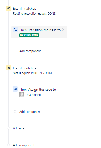

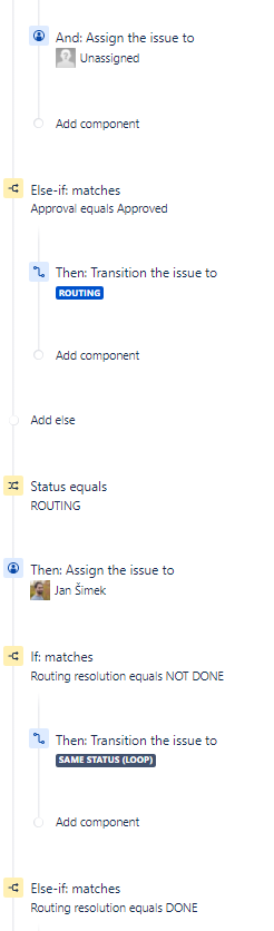

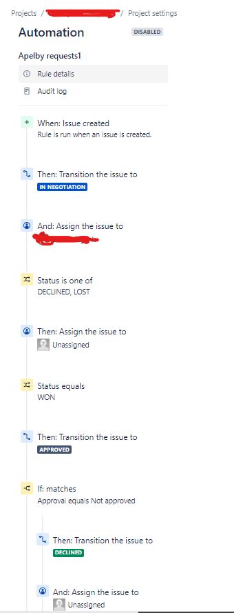

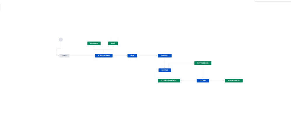

HI, thanks for answer, posting my workflow and rule, which i tried to build upon it. The rule is quite long so it has to be in 3 different pictures. I have changed a bit a workflow from then, so it is not actually up to date, but anyway it still did not work. If I remember correctly it stopped by status IN NEGOTIATION and I could not find a way it to work.

Your rule seems to be triggered on Issue Created, and then tries to process multiple things based on things happening later, like changing status or the values of Approval.  And then it checks different and contradictory conditions.  That is not now automation rules work...
When something happens to an issue, it triggers an event, which a rule can "see" and then take action.  For example, you may want a rule trigged on Issue Transitioned (changed status) to DECLINED or LOST, and then take appropriate actions.
Please pause to consider which events you want to "see" and what actions you want to take, and then build your rules one by one for the different cases.  It may be possible to combine some rules when the triggering event is the same.
