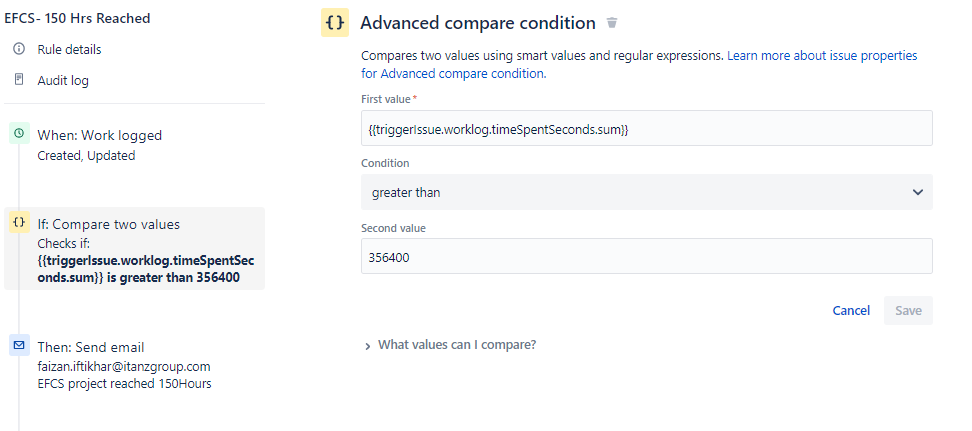

I have made rule with the help of Knowledge Article but not working, PFB link.
Have converted 99 Hrs. to seconds but the condition not matching. PFB screenshot... Need your input to settle it, please. Using Jira Service Management-SAAS

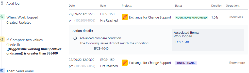

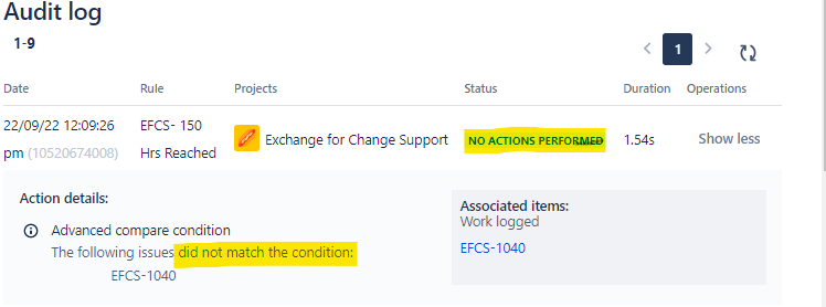

Objective:
When project crossed hours limit email generated
Problem facing:
Have set rule limit of 99 hours in seconds, have tested the rule by adding hours in project but it is not generating email notification . PFB snap for reference
Bill Sheboy
September 23, 2022
That is curious...

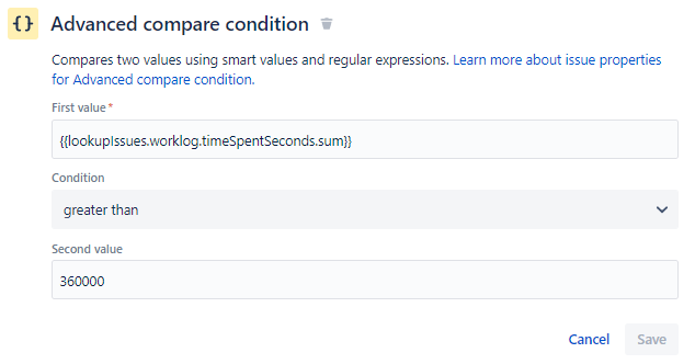

Would you please post an image of the details of the Advance Compare Condition?
And, perhaps add a statement before the condition to write to the audit log the sum value: {{triggerIssue.worklog.timeSpentSeconds.sum}}

Sure, PFB snap of condition. have already added above mentioned condition in Advance compare...

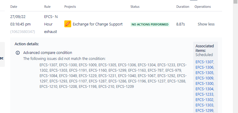

Faizan Iftikhar
September 27, 2022
Hi @Bill Sheboy
Appreciate your reply...
I hope, have incorporated correctly as Automation is not working.
Bill Sheboy
September 27, 2022

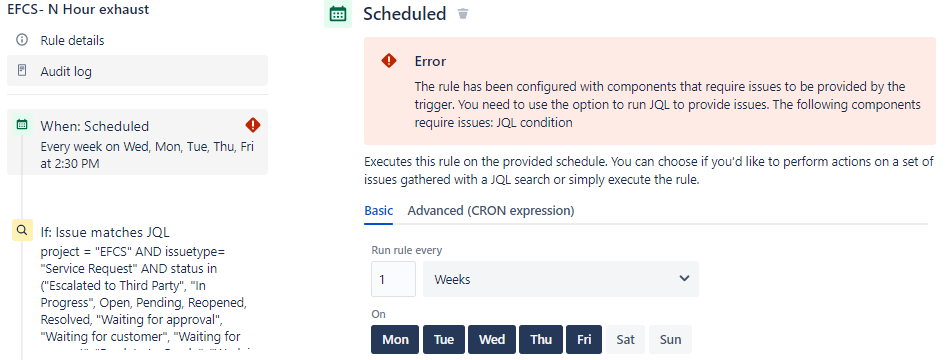

Two changes to make: remove the JQL from the scheduled trigger, and add a Lookup Issues action to use that JQL before your condition test.
Scheduled triggers may be used with or without JQL to gather issues.  For your use case, we want "no JQL" so the lookup can handle the issues.

if i am removing JQL form the scheduler it ended with error PFB.
Bill Sheboy
September 28, 2022
Did you also add the lookup issues action, as I cannot see the remainder of your rule.
That error seems to indicate that is not present yet.  Please see my earlier responses for details.  Thanks!

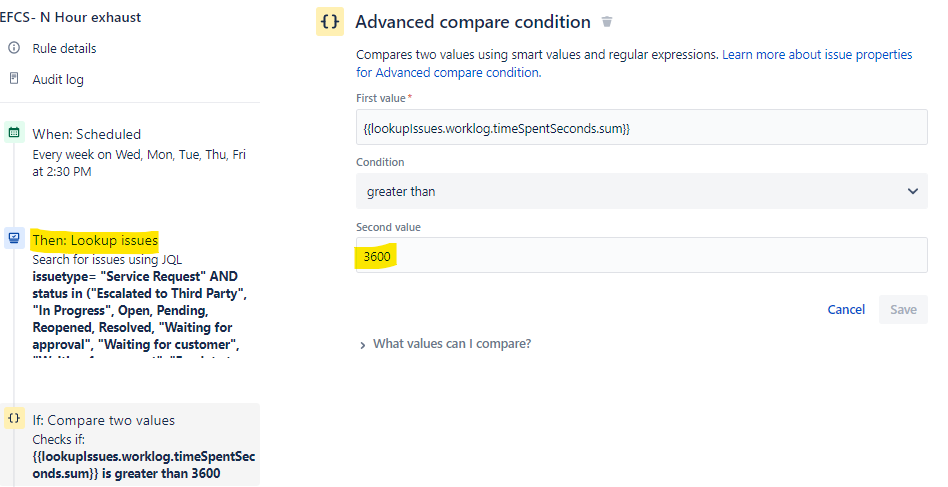

Sharing snap , hope it covers the whole scenario

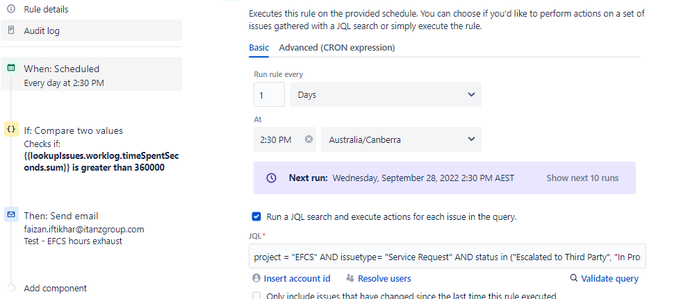

Please modify the rule like this to access the issue data...
  • trigger: your scheduled trigger
  • action: lookup issues with the JQL to find them
  • advanced compare condition: your test on the worklog from the lookup

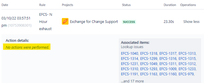

  1. I have put as lookup issue with JQL and it ended with no error PFB snap, thanks
  2. Now the Problem is in Audit log it shows success but no action performed, The threshold to raise trigger is 1 hour which is not working
  3. When project hours reached to 1 hour then send mail

Bill Sheboy
October 3, 2022
Two things to check:
Try running that JQL manually with advanced issue search (outside of the rule) to confirm it returns all of the issues you expect.
Next in the rule, after the Lookup Issues action, write the value for the sum of the time to the audit log.  Does it match what you expect for those issues?

After the lookup issues action, add a write to the audit log to check the value:
{{lookupIssues.worklog.timeSpentSeconds.sum}}
