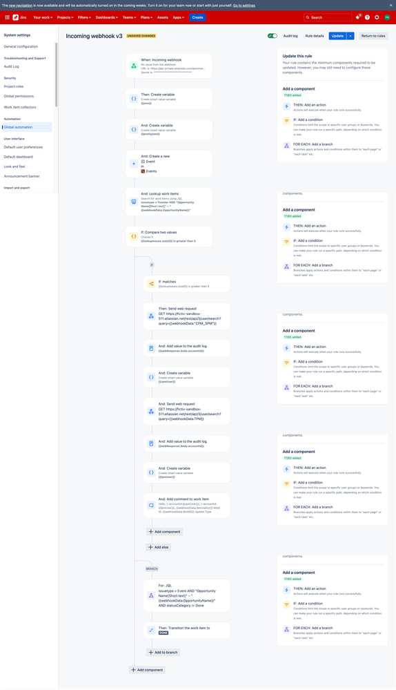

Could someone help me achieve the below using automations :
  1. When there is an incoming webhook, it creates an issue in a project ABC with type Event and copy the payload data to description.
  2. Search for issues in project XYZ where cfname = cfname in the payload
  3.  Add comment to the searched issue in XYZ project.
  4. Close the Event ticket that was created in ABC in step 1.

Priyanka Agrawal
May 8, 2025
Hi @Valerie Knapp , Thank you for replying.
Yes, I have come here after trying lots of things myself.
Here is the automation I've built and is not working as expected.
The automation should terminate if no issue is found in project XYZ. It should only close the issue created in project ABC if an issue with the matching criteria is found in XYZ. Otherwise, the ABC issue should remain open, as it serves as a log for automation failures."

Hi @Priyanka Agrawal
Adding to Valerie's suggestions...
Please also include and review the audit log details with your rule to help understand what is not working as expected.  From what you posted we can see:
  • The rule stops if no results are found in the Lookup Issues result, and so the if / else block is not needed; just run the steps, and...
  • Why are you using the REST API to perform the issues searches when additional Lookup Issues actions could be used?  Are these issues all in the same Jira Sites?
  • The way you structure the checks for the other issues could be done such that the rule halts when they are found, similar to your first Smart Values Condition on the Lookup Issues results
  • Finally, rather than using a JQL branch to access the newly created issue, instead try using the related issues branch to Most Recently Created Issue
