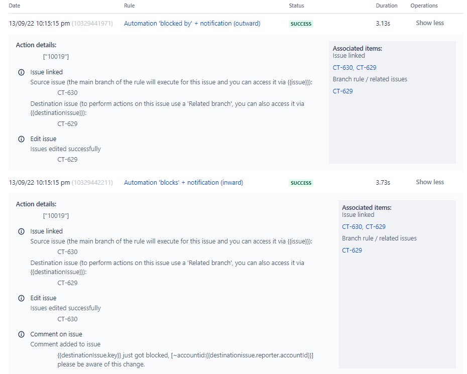

@Patrik Korovsky  thanks for the reply, i wan unable to reproduce your automation.
First of all, if i enable both, they run both, if i make one, then either is blocked by / blocks will not work
Secondly, it just copy links between 1 & 2 into a 3rd task. Not 3 & 2 link into a 1st one.

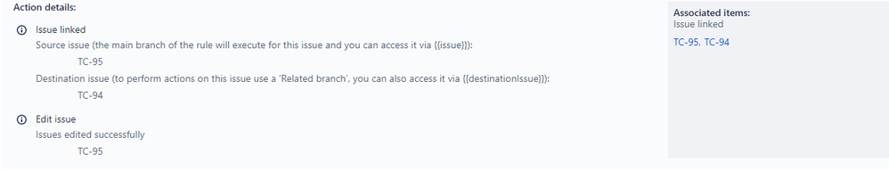

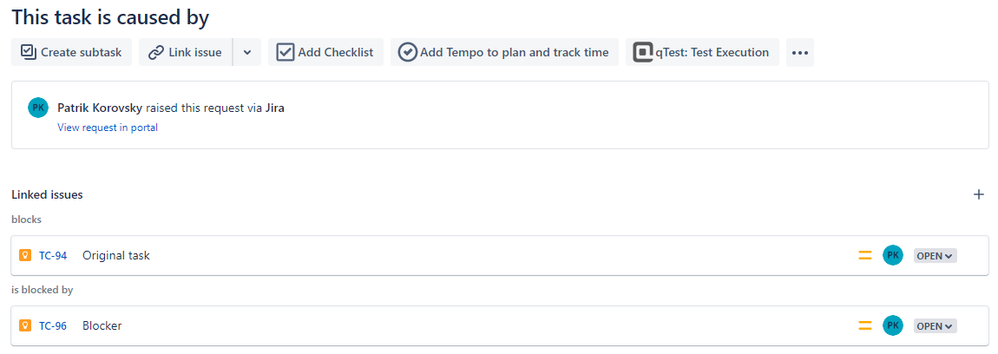

So I tried testing it in hopes of finding the problem:

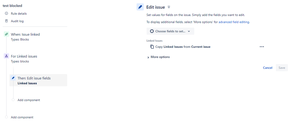

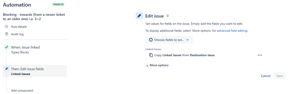

First I tested the automation that links "blocker" with "original task" when linking from "blocker" to the "this task is caused by" ticket. The test was performed using only the following automation, no others.
Automation:
Testing steps:

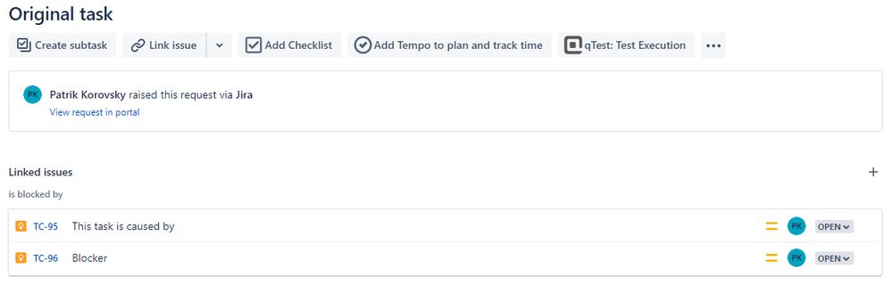

  1. I created the "original task" and "this task is caused by" and linked them (does not matter how)

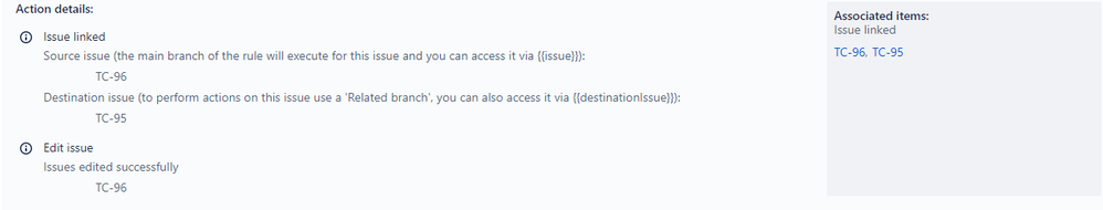

  2. I created the "blocker" and linked it to "this task is caused by"
Result: Working as expected

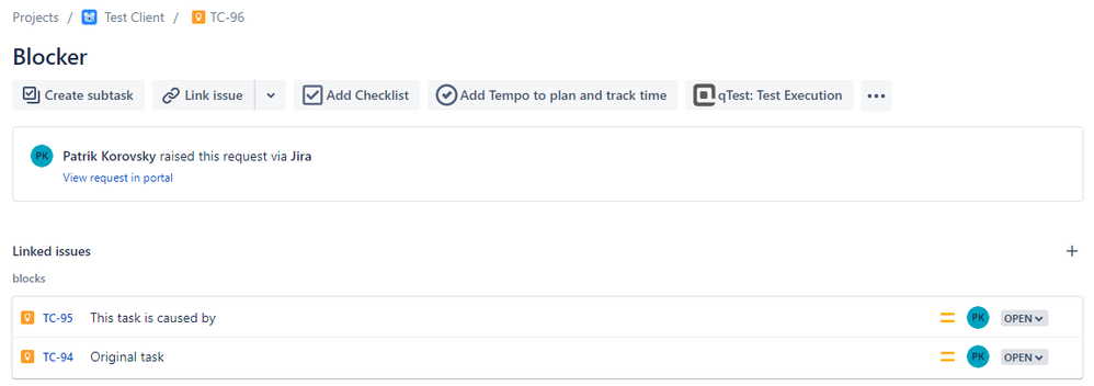

Initially, only the first and second tickets were linked. When the "Blocker" was linked to the "this task is caused by", it was also linked to the "Original ticket". It copied the links that existed in "this task is caused by".
The idea/goal was to copy the link that the second ticket has to the third.
"3" is linked to "2", then "3" copies the links from "2".
First ticket:
Second ticket:
Third ticket:
Conclusion:
In doing so, I found that this automation is sufficient for both cases of linking from the second ticket to the third and vice versa. This should work with an infinite number of blockers.
The automation adds all linked tickets with link either "blocked" or "is blocked by" in addition to the one you add. Essentially following the blocking logic.
Note that this automation copies ALL linked issues from one ticket to another, not only the "blocked" issues. This does not strike me as a problem because tickets are inherently linked by being blocked, so logically they are linked in these other ways. Potentially this could be avoided with "IF" conditions and other "THEN" actions, but that would require more time on my part or someone really adept at this.
Please try again, it worked correctly for me. It is possible that the second automation interfered with the first one.

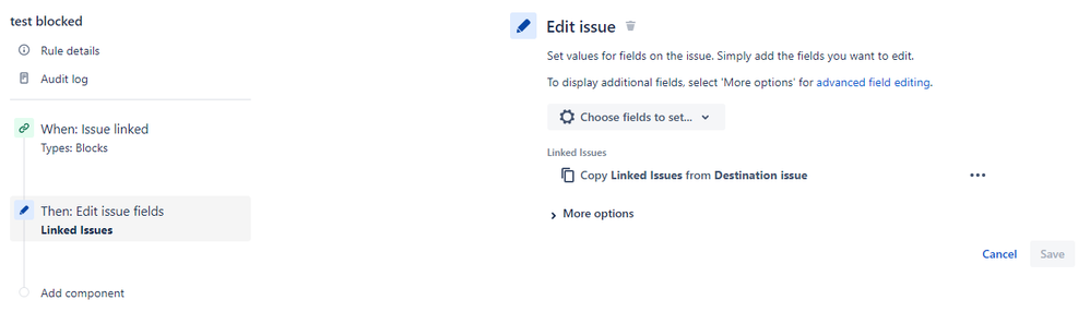

More on how I intended it and how I understand it.
In "when" we define that this automation should work for both "blocks" and "is blocked by".
  • The issue link trigger for "When" always uses the source in link types, in our case "blocks"
In "Then" we define that the ticket we are editing is the destination issue
  • The automation always edits the source (blocks - link type) to match the already linked tickets in the destination issue (is blocked by - link type). This is why it does not matter if we perform an inwards or outwards link type.
Logic (Source) explanation
  • If we link the 1st issue to the 2nd issue by "is blocked by", and then the 2nd issue to the 3rd issue by "is blocked by"
    • The 3rd issue is the source, because in our operation it acquires the link type "blocks"
  • If we link the 1st issue to the 2nd issue by "is blocked by", and then the 3rd issue to the 2nd issue by "blocks"
  • If we link 1. -> 2. -> 3. <- 4.
    • Then the already existing "blocks" 1. and 2. in 3. are copied to 4. because we are copying the destination to the source, in this case we are adding a blocker (source) 4. to the issue 3. (destination).
      • In doing so, the automation repeats and activates 3., because our automation is triggered by "When: Issue linked - types: Blocks"
        • 4. is then updated with all existing destination's of 3., in this case 2. and 1.

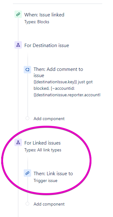

trying to follow here. In looking at this it seems that the circled bit would be trying to add links that already exist? In other words it seems that "for linked issues" that exist in the trigger issue you are the trying to link the to the trigger issue. I may need to try this but before I do maybe you can explain exactly your goal?
Alexey
September 9, 2022
Hey, my goal is to link new blocker to existing 'original' task.
