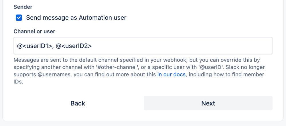

I have a weekly schedule at 9:00am (Monday to Friday) that runs a JQL query that looks for items that have been in the Peer Review column for more than 24hours.
I then have a slack message that is supposed to send direct messages to 2 of my engineers with the issue item info to remind them to do the peer review.
Here is a screenshot of what I have set up in the slack notification step
I have purposely not displayed my engineers slack userID numbers in the screenshot, but I am 100% certain that I the correct userIDs as per the Atlassian doc.
The audit log has a success record but my engineers did not receive a slack notification. What is interesting is that I received a slack notification but I assume I received it as the owner of the slack bot?

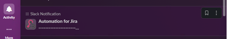

I tested using the Send Slack Message action to send a message to my own Slack account, with a webhook I had already confirmed worked successfully to send a message to a channel in the same Slack workspace. I found that the message appeared under my conversation with "Slack Bot" rather than in my direct DM. I found the message by clicking on the Activity button in Slack.
