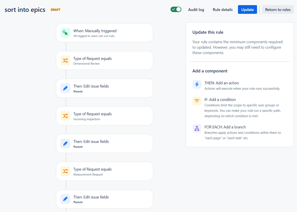

I'm attempting to do the same thing but I'm confused as to how to make this rule run on every issue in my project.
Would either of you be willing to describe this a little more? Specifically step 3.
See below what I currently have (sorry in advance for my newbie questions)

First, your rule should probably use an if / else condition structure rather than what you show: https://support.atlassian.com/cloud-automation/docs/jira-automation-conditions/#If-else-block
Next, please re-read the original steps described by @Dirk Ronsmans , where the rule is copied, the new rule's trigger is changed to scheduled, with JQL to find the issues you want to update.
Specifically, that JQL creates the "stopping condition", where the rule will keep finding issues to update until done.  In your case, that appears to be the presence of values in the Parent and Type of Request fields.
