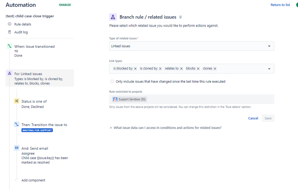

Thank you for your suggestion. I have been testing this out in my sandbox, but I'm not getting the rule to trigger for some reason. One clarification on my source issue. We are actually using 'Linked Issue' instead of a true parent-child case relationship. I noticed that while creating the rule you suggested and have tested with both 'Parent' as well as 'Linked Issue' Neither of these conditions seems to do the trick. Here is a snapshot of what my rule looks like currently.
I have confirmed that my source/parent issue is in a status that can transition to Waiting for Support.
Thanks,
Russ

Hi Russ - By reading through your rule, it appears that it takes the following actions:
  1. Issue transitions to Done
  2. branches into all issues that meet the criteria of PROJECT = Sandbox AND "blocks", "blocked by", "clones", "cloned by", and "relates to"
    1. For each linked issue, checks if Done or Declined
    2. Transitions each of the linked issues that are Done or Declined to Waiting for Support
    3. Sends an email to the assignee of that issue
Based upon your needs, my initial thoughts are:
  • If you're simulating parent child through links, this is fine, but you probably have too many link types.
    • If you're triggering off of your "child", you want the branch to focus on "Blocks" or "Clones".
    • If you're triggering off your parent, you want the branch to focus on "Blocked By" or "Cloned By"
  • I'm assuming that since you have multiple teams this is expected to be a cross-project rule.  That means your project scope (located under Rule Details) needs to be set to either multiple projects or Global
  • The branch condition seems off to me.  You're wanting to transition Done/Declined issues to Waiting for Support?
Like Filipi Lima likes this
    • [RW] - you are correct. I've narrowed this down to "Blocks" or "Clones" as I want the child/linked issue to trigger this rule.
    • [RW] - I think this might be what is holding me up. I just have this rule enabled for the sandbox project that the moment, which would be my parent/source project of the case. I am assuming that I would need to include all of the projects that I am syncing to (~20+ different projects) in order for this to fully work or else put this at the global level as you suggested. If I have this triggered at the global level, am I correct in assuming that the rule will just not trigger or transition the cases if those projects are not using the Waiting for Support status?
    • [RW] - I can see where this might seem off, but our process is that our Support team be the communication to our customers. I am currently linking a case to our Engineering team to work on defects or product enhancements. Our customer's do not have full vision into those cases so it is up to the Support team to notify the customer when a case closes or more information is needed; therefore, I want this rule to update the originating case to notify the Support team to take action.
