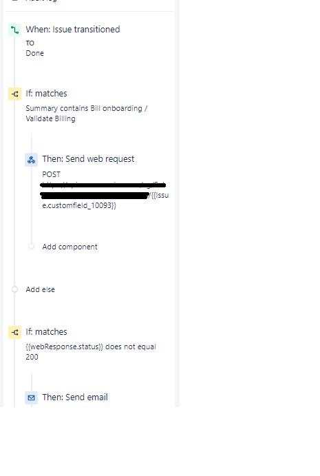

I need help finding a way to check a webResponse.
I currently have a process that is triggered by a Task that is changed to "Done".  Once that trigger occurs, I check to see IF it is a certain task. IF it is then call the "Send Web Request" function.  I then want to check IF the {{webResponse.Status}} != 200 => Send Email.
Problem is that {{webResponse}} is out of scope... If I create a variable that IS in scope, I cant seem to find a way to reassign it after the Web Request is made.
I also cant seem to create a nested if within the Scope of the WebRequest to check there.
 Anyone have suggestions or advice?

Metan
August 23, 2023
Metan
August 24, 2023
@Kian Stack Mumo Systems Above is the screenshot

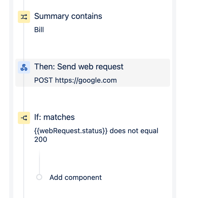

@Metan
Thanks for sharing. The issue is that you created two conditions that are "If/Else" blocks. As such, the call you make inside the first If/Else condition block, it will not be available in the next one you try to run.
Instead, for the first block, you should pick the Issue Fields condition, and then create a new If/Else block if the conditions passes.
It should look like this:

but wouldnt the Web Request need to be nested in the first IF block?
else itll do the first IF block, then do what is nested in there (nothing) then continue to do the webrequest
August 24, 2023
No.
The If blocks don't work quite the same way that they do in a coding language. In a coding language you would need to nest it inside of an if, but the way that the single "If" components work is that if the condition isn't met, the rest of the rule is not processed. Everything that comes underneath the singular "If" is "nested" by definition.
Does that make sense?

Metan
August 24, 2023
Wow.. Thats nice to know but weird haha.
Thank you!
