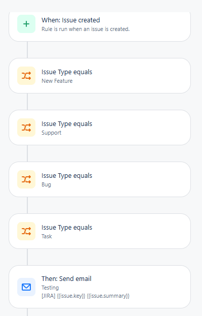

We have a project with a Notification scheme but we wanted to only notify groups of people depending on the issue type when an issue is created.  I've created the automation rule (below) and have tested it out a few times but it is not notifying the intended group.  Any ideas?

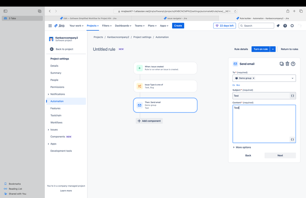

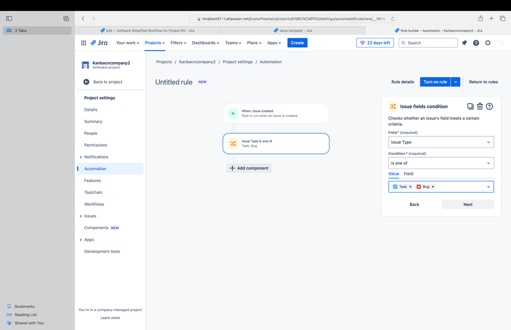

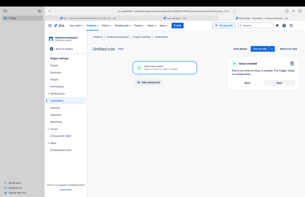

Hello, Good day. You could try the logic shown on the following screenshots.
Screenshot 2024-12-20 at 3.27.10 PM.pngScreenshot 2024-12-20 at 3.28.06 PM.pngScreenshot 2024-12-20 at 3.28.31 PM.png

It seems like you've set too many if conditions for your automation, basically reading your automation you are checking if the issue type is all of the listed which is why it won't work.
Additionally to what @Mohanraj Thangamuthu I can suggest adding branches for each of the issue types, it will make everything look much better and run in single automation:)

Thank you @Mohanraj Thangamuthu that worked!

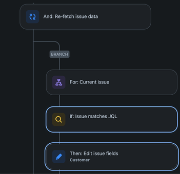

Basically you could build something like this:
You can add branch the same way as any other component
