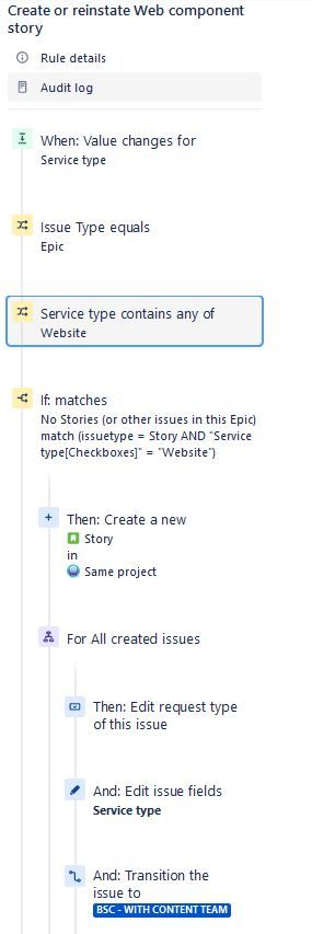

Thanks for the quick response. Perhaps I'm over thinking it. Here's what I have so far:

Actually just saw from another post I can use the smart value:
{{issue.customfield_XXXX.size}}
So I'll store that in a custom field that can then subsequently trigger the appropriate actions.
