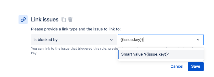

Hello @Kathryn Jenner
You can enter a smart value in that field by clicking in the space that says Trigger issue and starting to type in the smart value. After completing the smart value entry you click on the Smart value '{{... text so that it will be entered into the field.

We are missing information about how the rule is getting the value of the issue to which the trigger issue will be linked. It is possible that it is somehow retrieving that issue as part of the rule, in which case a smart value referencing that issue could be used.

That's where I'm not following your example answer. {{issue.key}} would give you the same issue you're triggering off, which OP said they didn't want.

My {{issue.key}} was just an example of a smart value, not necessarily the smart value that should be used in this rule. I was trying to point out that the action is not limited to just the two options listed, and a smart value could be used to specify a different issue (if the rule is constructed such that a smart value can be used to reference the target issue). I guess I should've provided more explanation.
Without additional information about the rule I could not provide a smart value that would work for that rule specifically.

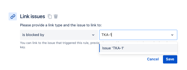

If the issue per Assignee is a fixed value that can be hardcoded, then yes, and If-Else block could be used to look at the Assignee and then link the trigger issue to an explicit issue. In the same manner as adding a smart value, you can click into the space that says Trigger Issue and start typing the issue key for the target issue.

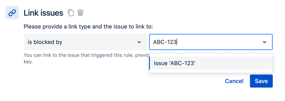

I believe you're trying to link to a specific issue (ex: ABC-123).
The UI here isn't super clear. When you initially open that dropdown, it'll only show you "Trigger Issue" and "Most recently created" as you've seen. What isn't immediately obvious is that if you click into that box and start typing a key (ex: ABC-123), there will then become an option to link to that specific issue.
Kathryn Jenner
May 15, 2023
Thank you. This was the issue!
