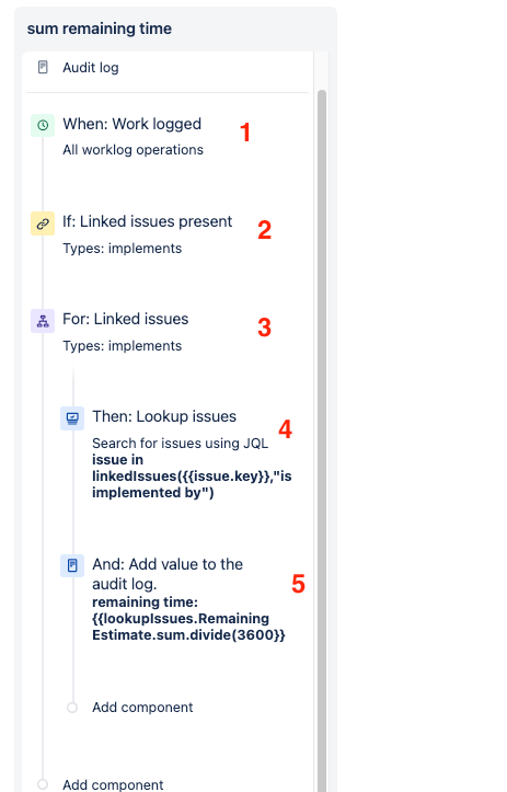

The rule you want would look something like this:
If you want this to run only when a Task type issue has work logged, then insert a Condition between 1 and 2 to check that the Issue Type for the triggering issue is a Task.
Step 2 is confirming that the trigger issue has issues linked to it such that the Task "implements" the linked issue.
Step 3 starts a loop to operate against all the issues from step 2.
If you only want to operate against Story type issues that are linked to the Task, then between step 3 and 4 add a Condition to check that the Issue Type is Story.
Step 4 is looking up all the issues linked by the "is implemented by" relationship to the issues that are linked to the Task by the "implements" relationship.
In Step 5 I am using a Log action to simply print the sum into the rule log. You would use and Edit Action to update the Story Points field with the same smart value.
Remaining Estimate is stored as seconds, so you need to use the divide() function to convert the seconds to the time value you want to record. In my case I selected hours (60 seconds * 60 minutes in an hour). If you want to convert it to days you would need to factor in the number of working hours you have defined for your days.

Hi @Yvonne and @Trudy P Claspill
That expression appears to be missing a closing parenthesis for the divide() function call, and has extra spaces in it. Please try this:
{{lookupIssues.Remaining Estimate.sum.divide(3600)}}And if that does not work, you can try the smart value, alias for the Remaining Estimate field:
{{lookupIssues.timeestimate.sum.divide(3600)}}Kind regards,
Bill
Hi Bill, thank you for the reply. I noticed the missing ) and tested. It worked perfectly!
