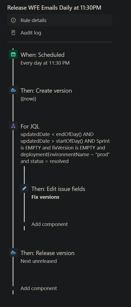

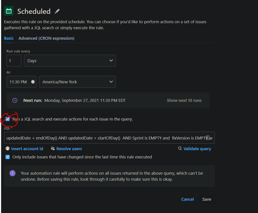

I have a an automation that runs every night at 11:30PM EST which queries a project and finds issue(s) wthat meet the critera. What I want it to do is create a single version then foreach issue found edit the version field to match the created version and then release the version

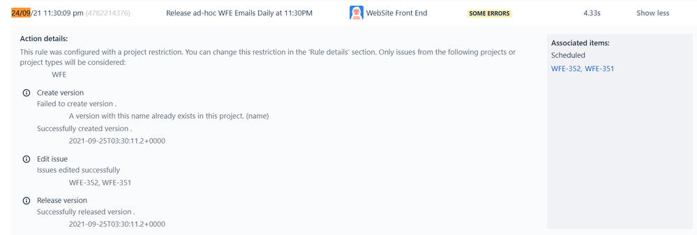

What is happening is it seems to have run twice?
Here is the query that is scoped to that project
updatedDate < endOfDay() AND updatedDate > startOfDay() AND Sprint is EMPTY and fixVersion is EMPTY and deploymentEnvironmentName ~ “prod“ and status = resolved
Any help would be appreciated

It looks like it is trying to create a version for every issue returned in your query.
I would remove the query from the Scheduled trigger part but leave the create version where it is.
Then change your Branch for JQL and put the query there.

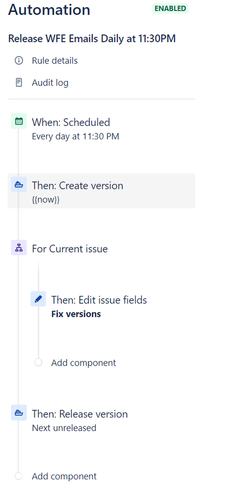

For documentation sake I removed the JQL from here and moved to a new branch
new layout:

Also do you think then I would be able to change my branch rule (in the second picture above) from JQL, as John suggested, to now be All Created issues? I may play with that in sandbox - basically trying to avoid having the JQL listed twice but its not the end of the world
Like John Funk likes this
John Funk
September 27, 2021
You aren't actually creating issues in this rule, so I don't think the All Created issues would apply. Plus you are running it at 11:30 pm so it shouldn't hurt to hit JQL twice.
